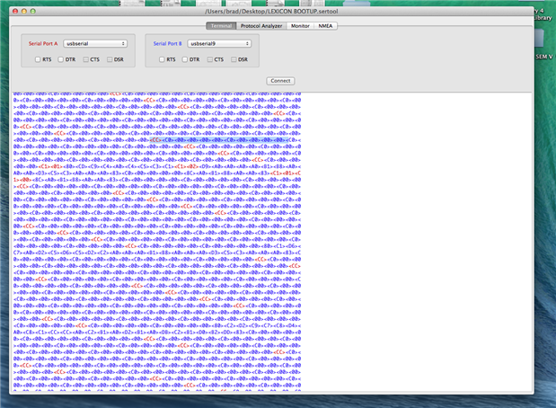

    I cant remember the make of the USB adaptors, but, (I think) i had some success this evening with more tinkering..
    I cut the serial cable in the middle and soldered both ends to a vero board with some headers in between, attached the usb convertor and started seeing a data stream.
    I started to build a map of what data was sent when moving controls and pressing buttons on the remote and, because of some of the data I read I believe that I must have the correct settings..
    Moving the faders on the unit in succession I see this:
    FADER 1
    <C0> - <value from 00 to FE>
    FADER 2
    <C1> - <value from 00 to FE>
    FADER 3
    <C2> <value from 00 to FE>
    and so on...
    When Fader 1 is moved it sends <C0><00><C0><01> etc etc all the way to <FE> I believe this is 0-255 so because that makes sense and is coherent should I assume I'm getting valid data?
    Now, the host (not a pc, a rack unit controlled by an old 70s single board computer) sends back data when it recieves these commands.
    I'm expecting this to be packets to update the Litronix displays etc. however, I havent been able to pull any ascii characters out of the reponses, which in teh service manual says each one of those displays accepts an hex ASCII value to display the char.
    Additionally after a few seconds the host sends another flurry of data at which time the displays update to display the previous characters before a control was moved.
    using hyperterminal, I wasnt able to get any intelligble characters, only loads of diamonds, ampersands and smilly faces. alll strange ascii characters.
    I resorted to a serial port monitor program on mac to get the above results.
    Am I on the right path?
    I guess I need to figure out these responses next?
    0 e14 Contributor over 11 years ago
    Also, forgot to mention, I also recorded the bi-directional data using both usb adaptors.
    That the host was sending on one and what the remote was sending on the other.
    In the screen shot attached, you can see that at idle, the remote (displayed in red) site there constantly spitting out <CC> while the host replies in BLUE (with 30 bytes??) with a repeating response until a parameter is changed.
    You can see from this where I got my results...

    0 michaelkellett over 11 years ago in reply to e14 Contributor
    It looks as if you are on your way - if I were you the next thing I would do is to write my own program to run on MAC or PC to present and log the data (unless you can configure the terminal prog to do this). It would be much easier to understand if it's presented in packets the way the devices send it and then as you start to understand it you can add decoding features to your prog. I would would use the original Visual Basic (VB6) to do this but no doubt others would use something written in this century.
    thank you very much for all your help Michael,
    You were right about the manual not always being right.
    After messing (for many hours) I found that the data was in fact 7 bits. as soon as I switched this, I started seeing much better data. ASCII characters etc..
    From this I have now been able to make a map of off the comands the remote sends and observed how the responses come back to the remote for the lcd displays.
