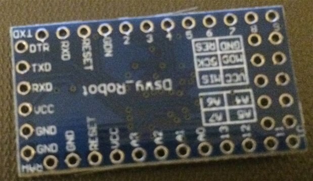

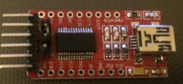

    I am inserting images of my Pro Mini and my FTDI (sorry they are crappy they were taken with my phone and it sucks at Macro)
    How do I tell if the Pro Minis have the bootloader burned on them?
    How do I burn it if they do not?
    The FTDI labels are difficult to see so in the orientation in the pic from to to bottom
    DTR
    RX
    TX
    VCC
    CTS
    GND
    and yes, my Pro Mini is only printed on the back, which is really annoying once you have headers soldered on to it.
    0 mcb1 over 11 years ago in reply to funinalaska
    Andrew
    I think you'll find the answer is here.
    http://forum.arduino.cc/index.php?topic=217246.0
    It also tells how to resolve it.
