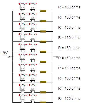

I have a simple project I need help with. It's a dual 10 LED light which hangs from my glasses to light the area I'm working on. It's nothing major but, I'm good at 3d printing but know very little in electronics. They are 3 mm LED's 3.2 volts 20 ma. Can someone help me with wiring this to an easy battery pack that I can attached to my belt etc. It needs to power 20 of them and last for 2-4 hours maybe. thx!

    I think the best solution is to make a parallel of two LEDs in  series (see diagram)
    Each 150 ohm resistor dissipates 60 mW, so 1/4 W resistors are fine
    I assumed that 9V alkaline battery are going to be used (mainyl because they are cheap and compact)
    The circuit draws current 200 mA. A 9V battery typically has a capacity of 400mAh so therically it would last 2 hours. You can wire two 9V batteries in parallel to extend this time
    Hope this helps!!
    Ambrogio

    The more in series the better and more efficient if your going to include a boost converter then perhaps 4 groups of 5 and about 18V supply
    don't forget though, if your using a LIPO, make sure its got protection, we dont want pre-mature failure or worse, personal harm from battery problems.
