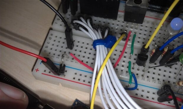

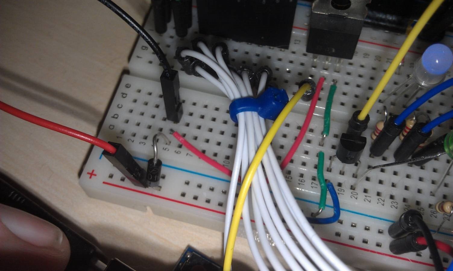

Been playing around with a DC motor #learningByDoing
And found for some reason, my DC motor wont discharge at a normal rate/instant,
It's as if it keeps power, but it's slowing down, slower.. slower.. slower..  until it finally stops.
The motor is connected to the black/red wires to the left, and have a diode as fly back.
It's grounded through the P-fet in the top, via the red wire, and green to ground.
Yellow is the signal from the arduino on port A0,
See the video --
So what am i doing wrong here, since the charge is not instant?

    Hi Martin, I would put the motor and PFET on a seperate power supply and see what happens. Also you could look to see what is happening voltage wise or PWM at the gate of the PFET as this is what should control the motor speed. I do not know what your control circui or logic looks like so it is difficult to comment further. Interesting phenomenon and my curiousity is peaked. Look at your voltage changes preferably with a scope and trace back to the cause.

    0 Former Member over 11 years ago in reply to jw0752
    After your suggestions i took the fet out of circuit measured it and testet it with a LED, checks out ok.
    Checked my voltages while "turning off" the DC.  and aparently it's the Arduino doing this.
    I was using digitalWrite on Analog 0, which usually works fine.
    But when measuring the voltage, aparently the voltage drops slowly as if it was a capacitor charging.
    anyway, change the code to analogWrite 0 and 255 for on and off, and now it turn on and off instantly as exspected.
    Strange...

    You say your using a PFET
    Is this a P Channel MOSFET or something else, can you please provide the part number
    The way you have everything connected as best I can see, the motor is on the high side of the supply and the FET is taking the black wire of the motor to ground based on the output of the Arduino, please confirm, provide a hand drawn schematic if needed to help
    If my assumption is correct then you have the wrong device
    PChannel fets need their gate taken to a negative value relative to the source and as this is connected through the motor to plus V, it should turn on but then once on it will sit at a floating voltage as now a current is passing through it, the source is no longet at +V, even when the gate goes back to +V, the back emf even with the diode still may be enough to sustain a small current (Heavy capacitive coupling between the pins of a fet), if you have a scope, you may see it oscillating
    If the PFET is connected to the high side of the power then you would need to pull the gate atleast 4V below the source to get it to turn on and even then only partly, this is the prefered configuration for a pchannel fet used as a switch, for low side, use an NChannel fet
    Hope this helps, if not, provide the schematic and a part number of the fet in use
