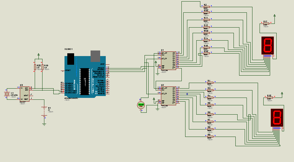

hello everyone,
Am a follower of Jeremy Blum tutorials and his book exploring arduino is the one assist me to know element14 arduino community.
my problem is how i can use DS1307 to track time for counting days and display it on seven segment display. i want counter to counting up days from 00 day to 99 days i.e counting up ( incrementing by one number) at the interval of 24hrs. However i manage to count with the use of  millis() but problem comes as i introduce RTC.....i want to use RTC for assisting counting number of days because millis() is messing on me once the arduino power is off.
i have
1. Arduino Uno
2. RTC-ds1307
3. crystal 32.768kHz
4. 2 pull up resistor each 2.2k
5. 2 Seven Segment Displays(Common Cathode)
6. 2 shift register, 74HC595
7. 16 resistor of 680Ohm for connection between shift registers and seven segment displays
i attachment of my diagram and arduino sketch for counting, anyone with the help in both diagram and arduino sketch i will appriciate.

here is my diagram:

    so are you able to read/write to the RTC chip through I2C interface, and display data read from it on to seven segment display?

    can you a bit more specific on what is working for you and what is not?
    are you able to display numbers on the display?

    Walter,
         Let's break this down to smaller problems. ok?
    1. Write a sketch to display "0" on the top control. If works try next one.
    2. Write a sketch to display "0" on the bottom display. If works try next one.
    3. Write a sketch to display "1" on the top display and "0" on the bottom display at the same time. tougher, but should show how to combine  top and bottom as well as display a new digit.
    4. Now write a sketch to write "1" top top and "0" to bottom. after a delay of 1 second, switch them to make "0" on the top and "1" on the bottom.
    5. Write a sketch to count "1" to "9" on the top and "0" to "9" on the bottom every second.
    By working step by step, you can learn to get where you want to go. The last step is to sample the time on the RTC chip and display the correct number of seconds doing this every second like before! Now pat yourself on the back for finishing this up.
