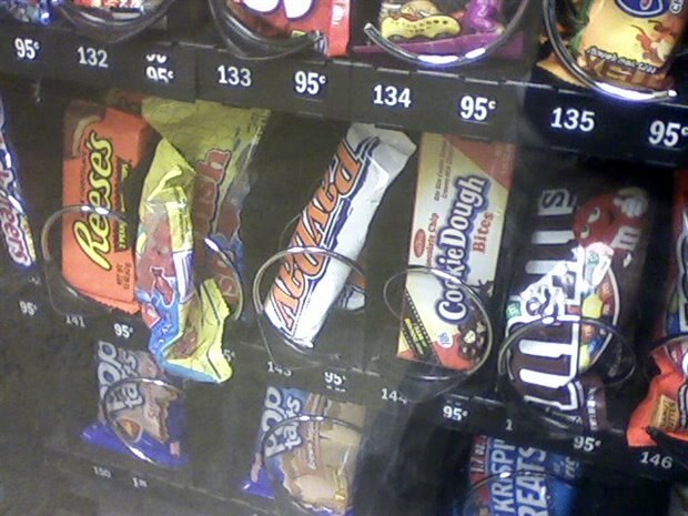

     To start i'm 15 and this is my first project that I have sat down and actually planned out. Also please note I have little to no programming skills. My plan is to build a vending machine that is powered by an arduino board. The arduino would power servo motors that would then dispense the item. My question is where do I even start. What kind of motors should I get? Can the arduino even run several motors? How can I make this connectable to an outlet? (not battery powered). What equipment do I need? I have so many questions I could write book. Any design tips and help I can get would be great. Also any design changes you think would make the idea more efficient do share.Thanks.

    Thanks for the reply my original idea was to use servos to rotate a large coil that would then drop the item, but thinking about it a servo wouldn't work a would need a whole motor to rotate the coil to be ready to dispense again and servo would just rewind back to its previous state. Except I have no experience with the code. Would it be fairly difficult to make a code that rotates the motor enough to make only one item dispense? and also have a delay so it can't be spammed?
