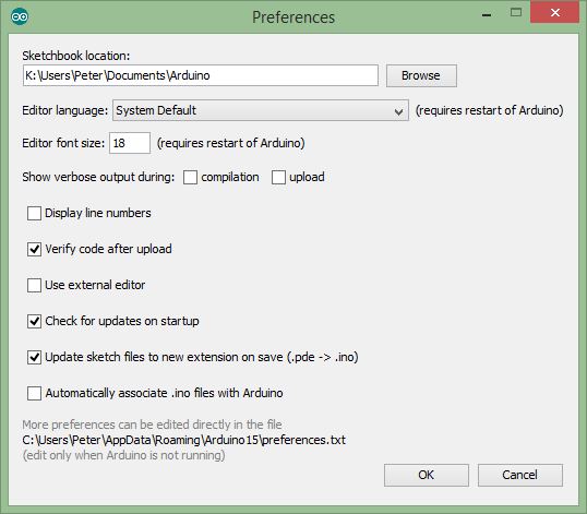

    It looks like your Arduino may not be programmed with a boot loader or the serial interface is damaged somehow I am assuming the Arduino does not complete loading or even starts loading there are switches…
  • Robert Peter Oakes
    0 Robert Peter Oakes over 11 years ago
    there are switches to have verbose logging, I suggest you turn this on and report what it tells you
    I would suggest turning on compilation and upload
    Regards
    Peter
