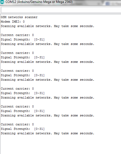

I am having trouble getting my new gsm shield to work on my mega adk. I am using the standard gsm library to use the demo gsm sketches and it is using the sim card that came with the shield.  I ma getting nothing out of  the serial monitor except the very first printouts saying that the system his running. For example if I upload the gsm scanner i get the message saying that the scanner is starting but I get nothing else output. I am using a power supply for the mega ( 9v) and the led that light up are the on and then the status one comes on and net flashes for a bit then all seems to go quiet.

OUTPUT:
GSM networks scanner
Modem IMEI:

  • hirayastudent
    0 hirayastudent over 9 years ago
    Good Day,
    I am using ATmega2560 and GSM shield 2 and I can send and receive SMS but the IMEI is 0. I attached a picture below. Pls help.image
