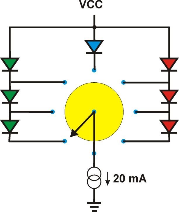

Hello all I have a very specific project I am working on and while I have a working prototype I feel that there are things I can do to further optimize the design.
What it is
This is a simple feedback system for people to rate content they are watching live on a scale from -3-0-+3. The system consists of seven LEDs three red, followed by one blue and three green. These are controlled via a seven position rotary switch. I currently have this all plugged into gpio pins on an arduino mega and I would like to reduce the number of pins I am using. The reason I am using so many pins is I need to be able to light the leds sequentially i.e. three red, two red, one red, blue always on, one green, two green, three green. Meanwhile the Arduino program outputs the current selection over the serial port to a program that records this output.
What i want to do
Basically I want to reduce my pincount using Charlieplexing or some sort of led driver. I am currently using up 14 pins on the Arduino and I want to incorporate some other functions into this system. I am thinking charlieplexing is the answer but if there is a better solution I am open to suggestions!

    The rotary switch could be wired to turn on the LEDs directly - then all you need to do is sense switch position with the Arduino.

    Douglas, that is looking like what I need as far as the order of the LEDs. Stupid question, but would switch position open=pin HIGH and switch position closed=pin LOW on the arduino in this case? Or do I have it backward?
    0 dougw over 11 years ago in reply to e14 Contributor
    If you put a pullup resistor on each cathode, then the pin with the lowest voltage is the selected pin.
    This scheme would imply using 7 analog inputs. Note that some voltage dividers might be needed to keep the analog voltages in range of the Arduino.
    Another method would be to use a dual gang rotary switch or a switch with 2 wipers, then the second switch could be setup for sensing position independent of the LED circuit. (a switch with 16 or 18 pins but only 7 or 8 positions)
    There are several ways to connect the LEDs and the switch that would all work, depending on how many extra components you want to add, and what type of power supply you have available.

    If you have an extra analog pin you could wire the second switch to output a voltage that indicates which position is selected - just put a series of 7 resistors between VCC and ground and wire the switch to tap into each junction. This whole system would only use one pin on the arduino.
