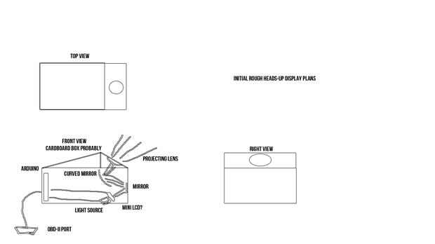

    Hey guys, yes I was planning on using the OBD-II port, the only thing that I'm having problems figuring out is what could I use as a display to project the information up onto the window. Now, I came up with an initial rough sketch for the HUD but yet again I don't know what kind of display I would need. I was thinking some kind of LCD because my father owns a computer repair shop and he fixes iPhone screens and there are probably a million of unused LCD screens lying around and so that comes free to me basically. Now the
    only problem I'd have with that is then finding a connection to connect it to the Arduino module. And another problem I just thought of would be a power source, I could use the 12v port the cars come with but that would look very...for a lack of a better work, ugly. But if thats my only option this would be completely find this is for learning purposes anyway. Any feedback on my plans would be much appreciated. Thanks! image
  • amgalbu
    0 amgalbu over 10 years ago in reply to Former Member
    Hi @Eric Rodriguez
    most recent cars have a USB plug.. so power supply should not be a problem
    Recycling a smartphone LCD could be a bit more trickier...
    Do you know the model of the LCD? Do you know the connector pinout? are you good at soldering incredibly small connectors?
