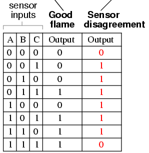

    With relation to the logic, there is potential for conflicting conditions that your statements do not encompass, for example, what happens to 'LED1' if 'relay1' is closed and 'pushbutton1' is pressed?
    You might benefit from producing a truth-table that matches every possible input scenario to each output. For example:
