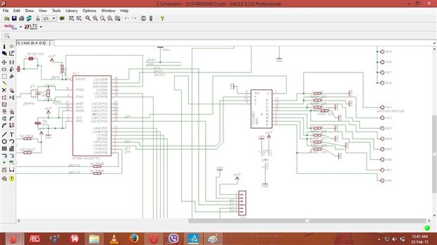

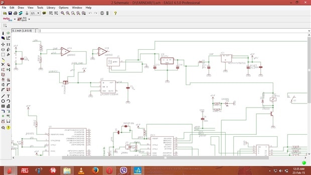

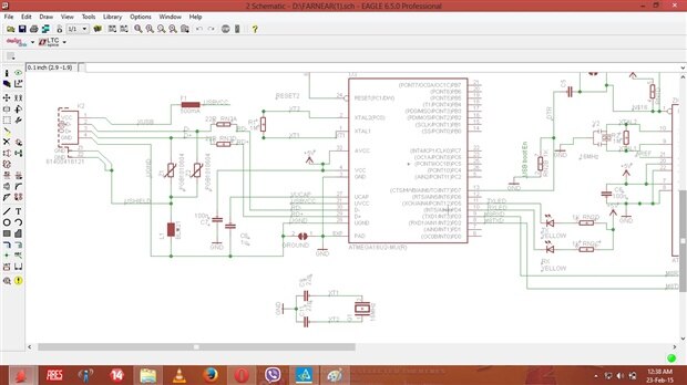

Hi,
I am new to this field, so u guys have to help me with this problem.   I have designed a custom ARDUINO UNO board using Eagle CAD for my project, I haven't changed much in the original arduino design, very little changes where made according to my need. I got the PCB fabricated and the components got  soldered. When i tried to plug the device to PC it got detected and i used FLIP to install the drivers. But the problem lies in uploading the code.when i try to upload a code snippet ( a basic example) , it shows an error like: avrdude:board not in sync . I have tried most of the tutorials given in internet for making the error fine. But nothing helped, so am uploading the design here , U guys please help with some solutions .

    0 mcb1 over 11 years ago in reply to Ramu
    Ramu
    Lets start with the basics.
    ENSURE you don't have anything plugged into Arduino Digital pins D0 or D1.
    If you follow the troubleshooting guide here, you can then refer to where it stops.
    Arduino - Troubleshooting
    In particular you need to select the correct board as it sets up the communication spedd relative to the bootloader you installed into the 328 chip.
    Windows does play funny with the UNO so check under the Device Manager when the board is plugged in.
    Don't be afraid to delete the driver and start again.
    Various antivirus software can interfere during the install process.
    I'm curious about the answer to this question.
    First, have you loaded the boot loader in the Arduino chip.

    Thanks Dave,
    I have used atmega 16 u2 , and uploaded the firmware.
    As far as I'm aware it is not possible to upload the bootloader using the serial connection on its own inot a raw chip.
    So my question is ...
         Did you purchase a 328 chip with the bootloader already installed.?
         If so,  which version of bootloader is installed.?
    re this
    it is recognised as usb device not specifically as arduino r freeduino
    The 16u2 will have a PID and UID programmed in which is licenced to arduino ... hence yours will be a standard USB connection.
    For comparison the official UNO circuit is here.
    http://arduino.cc/en/uploads/Main/arduino-uno-schematic.pdf
  • Ramu
    0 Ramu over 11 years ago in reply to mcb1
    As I understand You use atmega16u2 for USB to Serial conversion. and uploaded firmware to it. So I hope it is the correct one but for your Atmega328 you need bootloader too. And that you can only do with programmer mkII or usbasp. In some cases you can use other arduino as a programmer.
    Its all here: https://learn.sparkfun.com/tutorials/installing-an-arduino-bootloader/connecting-the-programmer
    And like I sead. I do not know why, but sometimes atmega16u2 fails to program the main chip. I had this problem with 2 or 3 adruino boards (we have about 14 of them) over 23 or 3 years of using them. so this may be tour problem.
    And like mcb1 seas, be shure not to connect anything to serial pins when programming it.
    By the way. is your main chip showing any signs of life? can you use some programmer and read its signature and memory? Maybe it is dead?
  • ramyar
    0 ramyar over 11 years ago in reply to mcb1
    The main chip is Atmega8a,it has a built in boot program.To burn it,which board has to be connected to the pc.I am just starting to learn programming with arduino.

    0 mcb1 over 11 years ago in reply to ramyar
    We seem  to have two different people having issues with Arduino.
    Dhananjayan Selvaraj has a 328 on a custom board and hasn;t replied about the bootloader.
    Meanwhile
    Ramya A has a problem with an Atmega8 but not supporting info.
