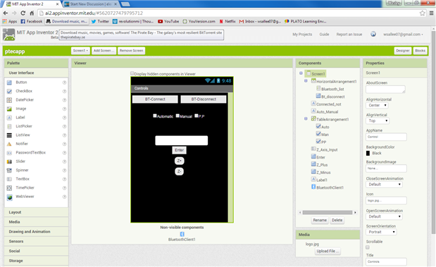

I am working with the arduino uno and an HC-06 bluetooth module. My project is for my job and in the end will control the processes of a laser cutting head. basically we have an app that is the "control panel" and controls the arduino. the arduino then controls a PLC which then is sent elsewhere to sensors and the laser. I have the basics done I think but I am stuck trying to figure out how to make the arduino read if there is an error in the system and show a notice message on the app. Also in the app there is a numbers only text box that will be used to manually send measurments to tell the laser where to be. I have no idea how i would write that in arduino. Any help is useful. Here is my code so far...

the app is through MIT app inventor 2 if anyone can help on that end it would be much appreciated. heres a screen shot of what it looks like for visual use...

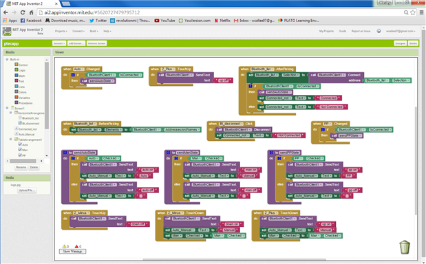

    The arduino code responds based off of the text that is sent from the app. Here is the block code i have so far for the basic funtions of the app. All i need to do now is be able to recieve some sort of…
    Here is the block code i have so far for the basic funtions of the app. All i need to do now is be able to recieve some sort of byte that can be traslated into text on the app  for errors/comfirmation that something is running.
  • gadget.iom

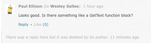

    0 gadget.iom over 10 years ago in reply to Former Member
    Looks good. Is there something like a GetText function block?
  • gadget.iom
    0 gadget.iom over 10 years ago in reply to gadget.iom
    Was it something I said?

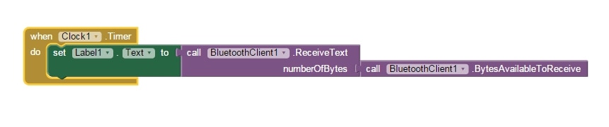

    wsallee07 Hi Wesley
    You probably need to include a clock in your App design
    and then you can use something like this code block to check for data from the Arduino every time the clock fires:
    Also, I wonder if you replaced the text strings your App sends out, with single characters, then you could simplify the Arduino sketch by replacing the Ifs and If..elses with a switch...case statement?
    Hope this helps
    Neil
