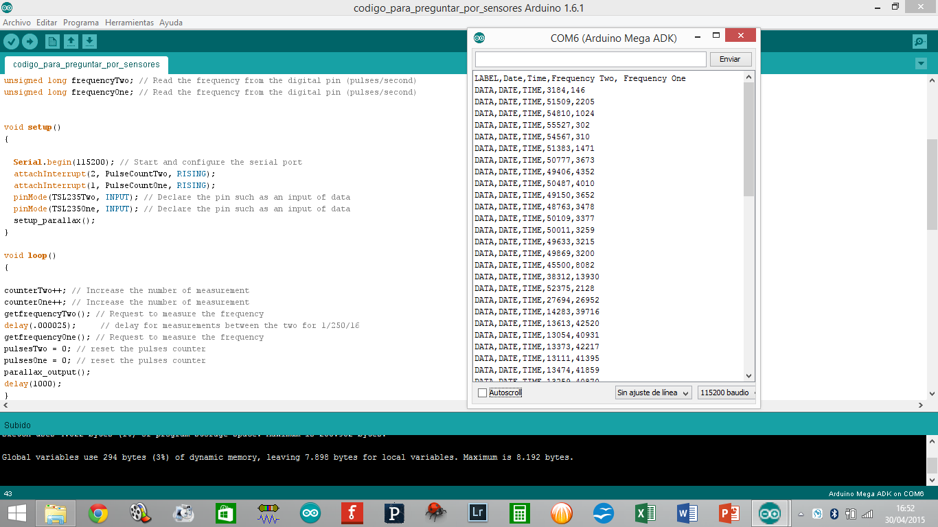

    0 aureta over 10 years ago in reply to clem57
    Hi Clem, I did try. there still interference, I include a snapshot of the SM. Under the same light conditions, when the sketch starts there is a high count number from sensor at  timer 2 (read before delay), not the results shown by the other one (right column). After a while I obstruct the sensor plugged at timer 1 without any significant change in the output from either one of these.  I then obstruct the sensor plugged at timer 2, this time the readings from sensor at timer one drops quite dramatically while the reading from the sensor plugged at timer two increases (?¿). I added a final delay at the loop but it didn´t have any effect. image
  • clem57
    0 clem57 over 10 years ago in reply to aureta
    Interesting. Would you like to try changing sensor one to a falling signal and leaving sensor two to a rising signal?
    Clem
  • aureta
    0 aureta over 10 years ago in reply to aureta
    i was trying just that but the behavior is basically the same...
