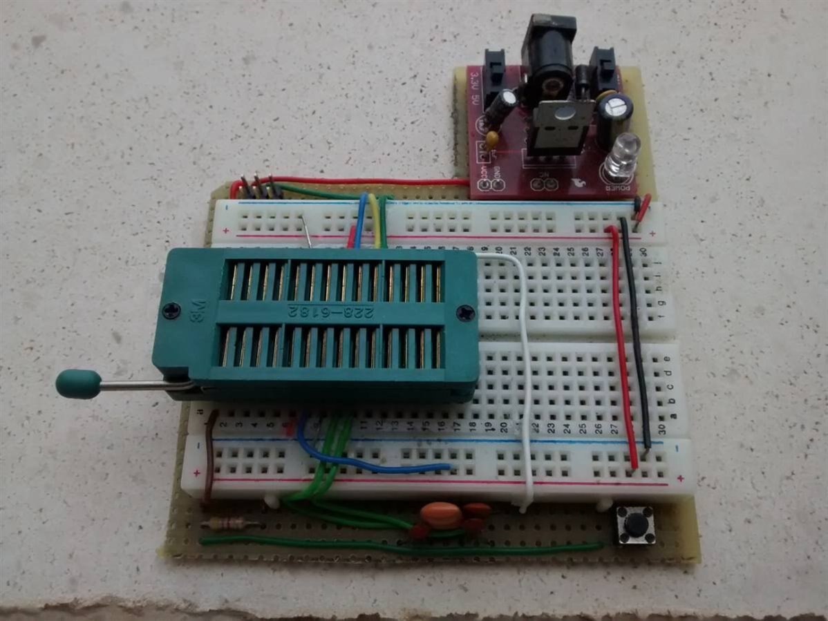

    0 balearicdynamics over 10 years ago
    I have used one of these and it works. Tested few time ago to see how W8 was working, because as a matter of fact I have almost all the C++ development environment working on a Windows7 machine so I have only put a try. But if you have one Arduino at-home (Arduino duemilanove and UNO R2/3 works fine) you can do a very minimal circuit to program from the IDE your AVR with the Arduino. It is one of the options of the IDE.
    To speedup the development from the AVR Studio I have bought and I am using a standard AVR MKII programmer from Atmel but it is almost expensive (+/- 30$) and it is the worth only with the AVR Studio because it is the most compatible ISP programmer for fast developing. You can see it here: Connecting Atmel AVRISP mkII - - AVRISP MkII
    Instead to program multiple units and save time and money, you can do one for yourself for about the half of the cost of the Pololu with a simple - minimal - circuit I show in the image below. It has the advantage that with a zero-force connector it is fast and secure to put the microcontroller chip inside, program and remove. I had in past to write the same program for every test cycle on about 10 different units. If you need the circuit - very simple - for this silly programmer let me know.
