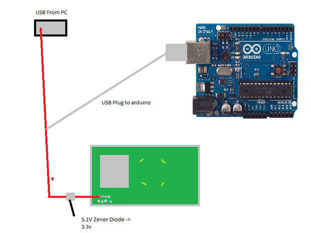

Hi. Im a newbie when it comes to this stuff but i recently bought an arduino and i was wondering if i could use the arduino cable and splice into it and connect the arduino using standard 5v then add a zener diode on another wire attatched to the 5v wire. Can i do this? I need a 3.3v power source and 5v for the arduino without using 2 usb cables. I know its probably the bad way of doing it. Im just curious to see if i can do it. Its the arduino uno.
Thanks

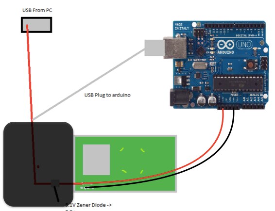

    No worries. I have annotated your drawing with my suggested approach. Forget about anything within the greyed out box area and consider adding the two wires I have added in:

    Its the arduino Uno. i purchased from Maplins in UK yesterday. basically i was wondering if i can do this. i drew a diagram.image
    I appologise for the bad drawing but. can i do this. have the arduino and the Xbox 360 RF board (needs 3.3v) connected to 1 USB cable or will this cause problems?

    that would be a better alternative. the only problem is that the RF module has 3.3v but you needed the zener diode to A) take it down to 3.3 and B) to prevent any voltage drops or something. it was to make sure the flow could only go to the Module and not come back. if i did that. i would risk burning the arduino out wouldnt i?

    From USB is 5V nominal, with a 5.1V zener used as a zener it would drop the whole 5V and leave you nothing for the 3V3 board. A standard diode will drop about 0.7V so 5V would become about 4.3V but with USB it could be less or more than 5V.
    The diagram that paulellison shows is utilizing the 3.3V output already available from the UNO and that is regulated so is just right for the board it is connecting to

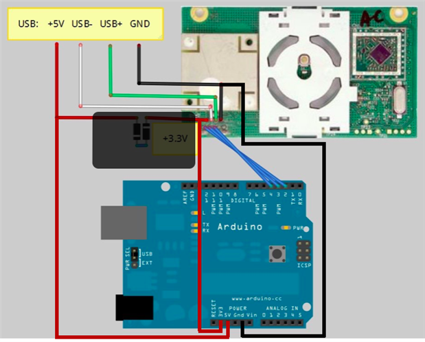

    Is this similar to what you are looking for?
    https://dilisilib.wordpress.com/hacking/xbox-360-rf-module-arduino/

    Ok. What you could do is adapt the diagram on that page, and wire it up in a similar approach to this:
    Again, ignore the greyed out parts. Put the 5V of your USB cable to the 5V on the Arduino. Connect the 3.3v terminal to your Xbox RF module, and link the GND of the Arduino to the USB GND.

    wont i need any diode on the 3.3v on the one to the RF module to prevent the current going back into the 3.3v line? the RF module is bi-directional or something

    A fly back diode would be a safe bet.
