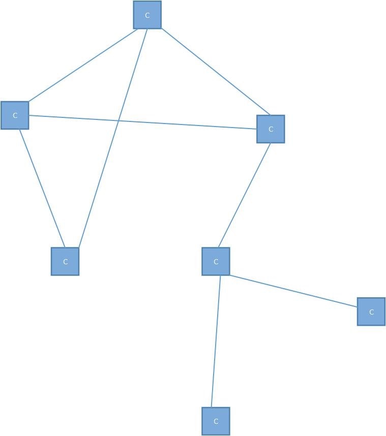

    my question is what if i wanted to branch out of one of the 4? what happens to the master/slave communication? essentially what i am wondering is that, is this network only supposed to work as a tree topology? could they not be mutually connected?

    I2C is typically connected in a bus configuration as shown in the linked tutorial.
    What do you mean by "mutually connected"?

    thank you; yes absolutely.
    what i meant was to have, as an example, a topology like this:

    I would personally recommend a bus network over 485. This will give you a decent transmission distance.
    The master can then poll the sensors as necessary. This kind of infrastructure is popular, and popular for a reason.
    Have you considered going wireless?

    I agree with Paul on this, RS485 is a proven industry workhorse over considerable distances and for wireless there is both Sub Ghz radios that are very inexpensive and also simple WIFI in the form of the ESP boards, also cheap and easy to use and very extendable over vast distances, did someone say across the otherside of the world image
    0 balearicdynamics over 10 years ago in reply to gadget.iom
    As a matter of fact IMHO the topology should be something like the USB hub architecture to you are covered for any needs and the bus really act as a bus. The selection bits are just to address multiple devices inside the same bus architecture.
