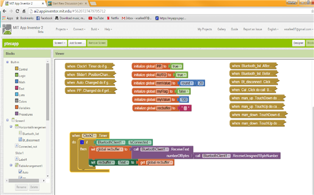

I need help figuring out how to revieve an input on an app inventor app from an arduino via bluetooth. i already have outputs from appinventor to arduino but now need to reverse that for about 5 inputs to the app. the problem is whatever i seem to do the app or arduino is not translating the data correctly and will not read the input and there for will not show a picture that it is suppose to when a certain input is recieved. Please help. Very important project for work and almost done! Nedd help ASAP!

Heres the app.

    Hi wsallee07
    Looking quickly at your AppInventor blocks of code, I can't decide if you are expecting to receive text or an unsigned 1 byte number - you appear to be trying to do both
    There are code blocks receiving for text and code blocks for receiving numbers in the Bluetooth section. I have never tried to mix them; I don't think it will work if you do.
    Hope this helps
    Neil
