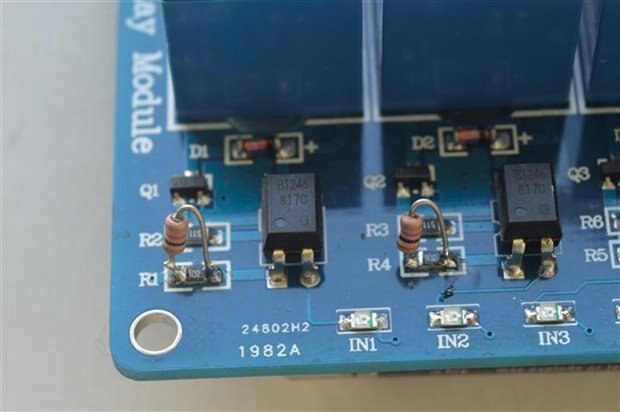

I bought this relay system and it doesn't work
http://www.ebay.com/itm/231573073495?_trksid=p2057872.m2749.l2649&ssPageName=STRK%3AMEBIDX%3AIT
Its a 12V relay system so I have to use 12V into the VCC and the input pins are driven by 5V.  So I connect 5V in, the relays trip.  The code is simple, digital high and low with a 1 second delay.  Pins are output.
The little LEDS turn off and on as expected but the relays do not trip.  I don't have a load on them but should not matter.  If I use 12V as required into the VCC, the leds only turn on, then go dimmer, never off.
I have a common ground between the arduino and relay board as well.
What is going on?
I went ahead and 2nd day aired a 5v version, I will just run it off the same regulator as the arduino.  Anybody have any experience with these?

    Joey Did you remove the jumper .. JD-VCC to VCC ? You apply the 12v to JD-VCC NOT THE VCC PIN The 5v on the VCC pin is to power the Optocouplers ... Also note that these turn on with a LOW so you need…

    Hi Joey, From my experience you will probably find that the 12 V relays will close at about 8 volts and release around 3 or 4 volts. If you have a variable voltage supply you can test this for yourself…

    The jumper is to allow you to completly isolate the drive tothe relays  from the drive to the opto isolators if you want to
    The optos can probable work on any voltage from 5V to 12V, it is what you use to drive the optos that will limit this. If you use an ULN2003 for example then it will work with 5-12 easily, if your running directly from the output of a controller then it will be limited to 5V (Assuming a 5V controller output but it will have to be able to sink 10mA ish.
    With the jumper removed you will NOT connect the GND lead to the controller, you will feed the VCC with the supply that is common to the controller (5V for example) and the controller will sink the current to its ground when it wants the relay to turn on
    the relay power (12V) would be supplied to the JDVcc pin and the ground of the relay board will goto the ground of the 12V supply only
    this would keep the micro completly isolated from the relay power so less noise interfering with the micro controller.
    if you have the jumper in place then you can not fed the micro power (5V) to the board as it will not work at that voltage (Relays) and if you power the board with 12V you will need an intermediate driver that will level shift the 5V from the controller to 12V  (IE a ULN2003, Transistor or FET... your choice). see this video for additional info:

    12V on the VCC did not work.  Which is odd considering is jumped to JD-VCC, even if I put 12V on the input pins.  I tried.
    In summary, with the jumper installed on the 12V relay system, the whole unit is useless, there is no configuration with the jumper installed that will work.  Even if you level shift the input, I tried.
    The input pins MUSt be 5V, no more.  VCC must be 5V, no more.  JD-Vcc must be 12V (or something close, I will test the lower limit but it is NOT 6.6V, that didn't fire them.)
    this is good information but keep in mine mine is a cheap Chinese knockoff, who knows how it was made and if it will behave as expected, we could discuss all day.  I could make a video proving each scenario, but that may only work for my specific unit!
    I still do not understand why the have a jumper when there are 12V relays and VCC cannot have more than 12V.  (If you put 12V the leds light up permanently while power is installed which is not a good sign)

    Most of these boards use a 1k ohm resistor in series with the opto and a LED, and hence at 5v the maximum current is approx 2.2mA (5v -1.4 - 1.4 (leds) = 2.2v  I=E/R = 2.2/1000 = 0.0022A or 2.2mA
    At 12v the current rises to 12-2.8 = 0.0092 or 9.2mA.
    The opto is capable of 50mA but I doubt the series LED is..image
    You do need to be aware of the device that is controlling the opto side. You have to ensure it doesn't have a voltage that exceeds its limits applied to it.!
    (GOLDEN RULE ... never apply a voltage to a pin that is greater than the supply UNLESS it is designed for it.)
    If you do stick 12v on a 5v device, depending on the device and its internal design, it might conduct this to the Vcc to protect itself.
    In the case of your opto board, if you draw current through the control pin, current flows from the Relay Board Vcc rail, through the series resistor, optocoupler (and indicator LED).
    This will cause the LED inside the opto to illuminate and turn on the output side.
    With the above in mind this statement is wrong.

    • Discconect it from your Arduino .!
    • Apply 12v to the VCC with the JD-VCC to VCC jumper in place and the ground of your 12v source connected to the ground connection.
    • Short any of IN1-IN4 to ground, and the correspnding led will light and the relay should be operated.
    If that doesn't work you better include a good photo of the top and bottom of the board as it would appear your little asian friends have got the wrong schematic ...
    WHY make them like this
    Many devices have Open Collector outputs, or use a transistor to do the switching. (those cheap PIR's do exactly this with a small resistor in series)
    The collector of the transistor connects to IN1-IN4 and when its ON the opto is ON which turns on the relay.

    I see what I said wrong, I mean that there is not configuration that will work with the jumper, using a 5V micro controller!  These are designed for micro controllers and I am not aware of one that will work with 12V.  I guess there would be a way with mosfet to sink it to ground or I could use a relay to sink the pin to ground, and that's the point.  To use 12V you would have to use another "relay" (fet etc..) to make the relay board work, makes 0 sense.  I need a relay board to operate the relay board.
    I actually did it wrong anyways and attempted to source 12v on the IN pins instead of sink it to ground.  I didn't try that.

    As jw0752 pointed out the schematic is seriously flawed ...with the shorted coil and the reverse LED nothing would work...image
    a small signal transistor will work fine ....
