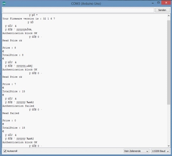

  • ritamüller
    ritamüller over 10 years ago in reply to Robert Peter Oakes
    Hallo Peter ,
    do you know how I get the Euro sign in same row with the Price ?
    why I get gobbledygook letter in my Serial monitor ?
    Thx
    Rita
  • Robert Peter Oakes
    Robert Peter Oakes over 10 years ago in reply to ritamüller
    Can you provide the sketch you are running for this
    Thanks
  • ritamüller
    Hallo Peter ,
    here is my sketch :

  • ritamüller
    Hallo Peter ,
    here is my sketch :
    Your routine that is called print() always puts a new line before it exits therefor your euro symbol will always be on a new line. remove this from the print routine and put the newline statements elsewhere if you need them

    also where you do this
    1.   Serial.println(TotalPrice,1);
    2.   Serial.write(thisByte);
    Serial.println vs Serial.print, the first one adds a new line before executing the next line so again adding a new line before you get to send the euro symbol, the second version does not so change your statement to the second version
    The other stuff is because your talking to your PN532 on the same serial as the console, or atleast that is what it seems so when you do things like sendTX(...) it will show up on the console, as this is not really printable ascii it looks like gobbledygook
    Provide your wireing schematic and or a link to the exact product your connecting and I can probably help further, I am assuming your using one of the ADAFRUIT boards but you dont say and are not showing any libraries so im guessing
    Peter
  • ritamüller
    Hi Peter ,
    Thanks for the tip I have now the Euro sign with prices in the same row.
    I have RFID 13.56 MHz / NFC Module for Arduino from Cooking Hacks https://www.cooking-hacks.com/documentation/tutorials/rfid-13-56-mhz-nfc-module-arduino-raspberry-pi-tutorial/#step3
    Regards
    Rita
    My assumption about the board is correct, it shares the serial (USB) between the PC console and the RFID reader and therefor you will not be able to eliminate the garbage looking text
    if you look closly on their site via your provided link, they have deliberatly dimmed out all the garbage to highlite the other text but it is still there and so even they acknowledge it is an issue (Expected behaviour)
    the only easy way around this would be to use an LCD display or something on the I2C but or using other GPIO pins to seperate the Human communications from the RFID communications. based on what I am seeing you do here, i dont think that would be too much of a challange for you
    regards
    Peter
