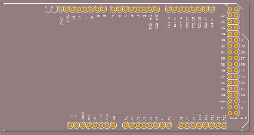

How do you mount a Mega on a PCB?
I'm using a Arduino Mega for a project and wanted to use Fritzing to create a PCB layout. The footprint for the Mega reflects the pinout of the motherboard. If I create a pin pattern on the board to mount the Mega directly to the board, then the pins need to be reversed. The Mega is flipped over and mounted face down on the PCB reversing the pinout.
I cannot find a pinout that reflects the Mega face down on a PCB. I would assume that is the way to install the board and not have a collection of jumpers running from the Mega board back to the PCB. If anyone has an insight I would welcome the input?

    I assume the PCB is plated through-hole? Put the footprint on the reverse of the PCB but actually solder the MEGA (or headers) onto the front of the board. That would work wouldn’t it?

    I would change the background colour so that you can see the white font. I did a quick test to prove and it is quite straightforward. If this is what you need, then I can place the modified fritzing…

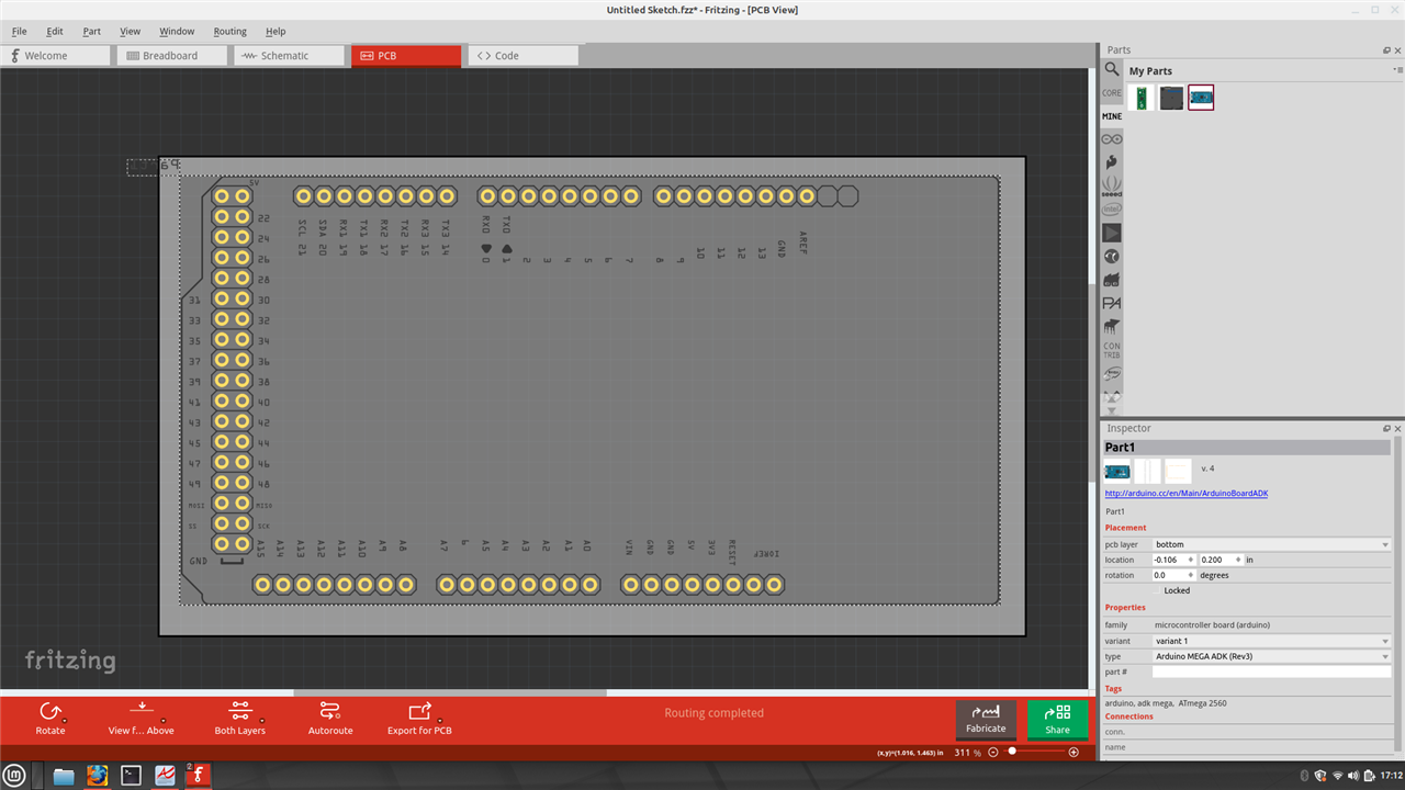

    In PCB mode, click on the footprint and then change "pcb layer" to bottom.

    0 colporteur over 4 years ago in reply to BigG
    Sorry for being tardy in my response. I've spent the last hour responding to messages regarding the successes I have had interacting with this site and let your message slip.
    Wait a minute? Your not standing at my desk. How would you know how long it has taken me to respond. I really have to get out more. This COVID isolation is making social media feel like human interaction. A little dig for cstanton:)
    Thank you for the share. I was not familiar with the selection option. Unfortunately, the silk screen number reversal thing, still happens, as I indicated in Image D above. I'm haven't mastered how to load additional footprints. Maybe the image errors are corrected in a more resent update.

    0 javagoza over 4 years ago in reply to colporteur
    silk screen is transparent and labels are white. Try to change inkskape document background color

  • BigG
    0 BigG over 4 years ago in reply to colporteur
    If this is what you need, then I can place the modified fritzing part on my github page and provide a link - I cannot see a means to attach a file inside a comment... as in it won't let me upload.
    Here is the modified SVG file, if that also helps.

  • colporteur
    0 colporteur over 4 years ago in reply to javagoza
    I might give the impression I know Inkscape but when someone who actually know the application and uses it, my skills are minimal in comparison. Your suggestion enable me to see the text. Thanks.
  • colporteur
    OK now that I can see the text me thinks there are other forces at play.
    The errant text is only on bottom side rendering of the Mega. This screen shot shows the text correctly.
    Maybe what is happening is normal and my lack of spacial recognition is the problem. I'm thinking what is on the screen is going to be what is printed. Is that correct for the reversed text on some Mega footprints.
    0 Jan Cumps over 4 years ago in reply to colporteur
    Bottom text appears reversed in the PCB editor.
    If you select the 3D renderer, you can rotate the result, and see the backside as if you have the PCB in your hand.
  • colporteur
    0 colporteur over 4 years ago in reply to Jan Cumps
    My PCB are for personal use, so poor silk screening is something I will have to accept to avoid breadboarding another unit. The first has been brutal!
  • BigG
    It is as per Jan Cumps reply.
    I think what you're after is quite tricky and will have to be done in Inkscape by changing the copper0 and copper1 group ID settings for the pins. One of the limitations of Fritzing is that you only have a single silkscreen layer.
  • colporteur
    As much as I would like to correct this, it is pushing the edge of my skill level and motivation.
    I have not been completely happy with Fritizing. I moved to the program from Eagle (step back) when it was not supported in Linux. I read /technologies/open-source-hardware/f/forum/50425/kicad-for-non-kicad-e-g-ex-eagle-enthusiasts---a-discussion with facination. Maybe a change in on the horizon.
  • colporteur
