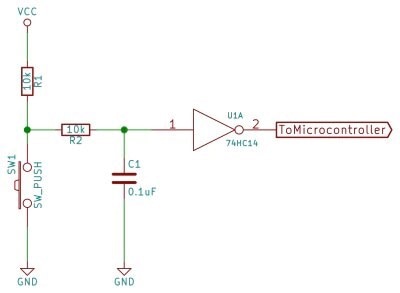

    /members/colporteur ok I use a lot of switches and have found the cheapest and easiest is to use a Schmitt Trigger (.64$ @digikey)/6 = 0.166$ for each section with an R/C filter. take a look at this blog of mine.
    imageimageThis is cheaper than the 555 solution, as for six debouncers but then you need a 555 (0.40$@digikey) * 2 = 0.80$) for your project. This gets pricey as they will require 2x resistors & capacitors, and a lot more soldering.
    Normally I put the R/C networks on an IC header if it is a 16 pin header I can put 4 networks on it. and this is on a Wire-Wrap socket.

  • colporteur
    colporteur over 4 years ago in reply to phoenixcomm
    It could use some investigation on my part, this schmitt trigger. I'm getting false starts on some animations and would like to find a solution. Got a part number? Looks like you designed a board to accommodate it.

    This TI documenthas part numbers and how to calculate values for a Schmitt trigger.

    /members/javagoza yes you are right, but It depends of what's going on with the software. I personally don't like to waste my CPU doing waits. with my Fuel Indicator I  have two switches both being an SPDT which means I have 5 states. 0 off,  Fill, Test, Set UP, Set Down, so the output of the Schmitt triggers go to a priority encoder inputs. whose output goes to an interrupt.  Here I have an ISR to determine what the code is 000, 001, 010, 011 this takes 3 bits as you don't have to read 0 as it is assumed. then you need to have 4 reads and a little hex math to get switch code.  and away you go.
