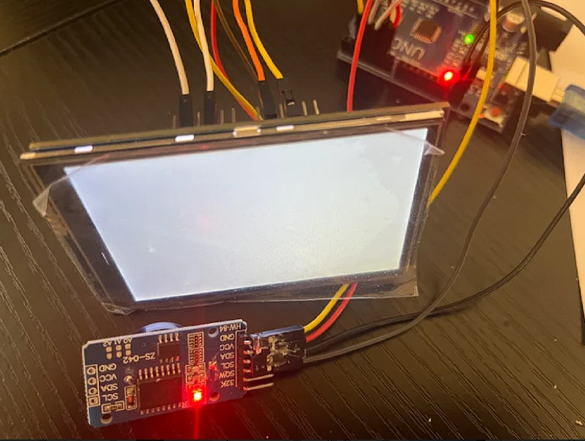

Hi, I was recently working on a new project which displayed time from a real time module to a Arduino TFT display using an Arduino UNO as the main board, however I'm still having trouble with it displaying anything on the screen as when I wire everything up and power the Arduino it just displays a white blank screen,
For the wiring I've made this diagram, (all parts in this diagram represent what I have):
And for the code I've added this:
I have double checked that the library's do work with my display.

I personally think that the issue is with the wiring however again I'm not sure if it is the code or wiring which I'm messing up, as when I wire everything up it just displays a blank screen like this:
Final goal target to be displayed on the screen:
If anyone has worked with such displays and knows what's the issue any help would be highly apricated, thanks!

    I think you've got the wrong sort of TFT display. It supports parallel connections (the serial connections are for sending static images perhaps). In any case, it's the wrong display for the code you're using. The display needs a more powerful board than Arduino Uno, if you wish to use graphics and text commands - I think.
    It's better to follow examples such as the one javagoza refers to, with the same TFT screen. You can't mix them, they have different driver chips.

    Those connections that he is using are not for communicating with the TFT display but for the SD card reader included in the display.
    These displays, as shabaz says, are for parallel communication and are prepared to be coupled with the board as a sandwich.

    Thanks for the reply's, however even with plugging it in directly im still getting a sort of black screen directly for a split second then a white screen.. at this point im just trying to display time on my display but im finding no article which actually works with my display no matter what I do, all posts including the ones javagoza referred to does not mention my display.
    There are ones which use my display but are for Arduino DUE which is discontinued and would set be back almost $85 if i were to buy one, plus im not trying to have any animations of some sort, I simply need the time displayed on my screen. :/

    It is what it is I'm afraid. You purchased a display which is not practically drivable with the Arduino Uno, because (repeating myself) it's a parallel interface, and your code isn't for that sort of display.
    You could investigate storing static time representations on the storage card and then control via serial (perhaps) but that's a completely different project, and you're unlikely to find much help in this area, because it's a weird way of doing it, and no-one normally would do that (if it even works). You'd be pretty much on your own, no-one is likely to have done it that way.
    Anyway, a TFT display is not $85. You can get smaller cheap ones for $10-$15 or so, that are compatible with Arduino Uno. Search for ones with I2C or SPI interface.
    Also, another option is to use a 16x2 LCD character display, if all you want is text. They are really low-cost too.  There is a ton of Arduino examples for the 16x2 displays, so you will have plenty of code to experiment with.
