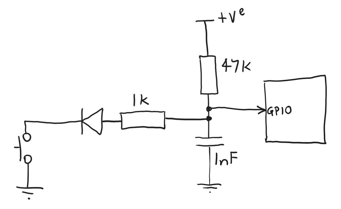

    shabaz over 3 years ago
    It's not an entirely "debounce" problem. Debounce is just part of it. That's why you're seeing so many possible approaches to resolve it. The title and discussion content initially only mentioned debounce, and didn't mention the noise issues and that the input was on the end of a long wire. Many people assume it's the same as a short wire, but it isn't. If it were a short wire, the problem would indeed be a solely debounce related one.
    The scenario is an input at the end of a long wire, in an environment that could be noisy.
    The situation could be better described as "remote switched input" or "remote line interfacing" perhaps; I don't know what the best technical term would be. In any case, you're interfacing _external_ hardware (a switch) to a computer's naked CMOS input (it has some protection built-in, but not a lot).
    Connecting things off-board is a more solution-level problem, whereas "debouncing" alone is local to the product.
    There are tons of solutions for remote connected devices to interface. A GPIO pin isn't (usually) a remote interface. Hardware is needed in-between. People often connect up I2C devices or long-wire outputs or switches off the end of meters of cable, directly to the GPIO, and 5 times out of 10 it might work for some of the time, and then even if it does work, then things might start misbehaving as the environment changes!
    The solution often involves some or all of these (this list is not exhaustive, it's all I could come up with for now):
    (1) implement debouncing (this is needed anyway even for a local switch on a board inside a product) either through software or hardware or a combination
    (2) noise reduction through (say) filtering; this too could partially be done in software, but clearly is feasible and often necessary with hardware too
    (3) increasing the noise immunity through greater hysteresis; this often involves using a schmitt trigger
    (4) increasing the noise immunity through greater voltage thresholds and lowering input impedance
    (5) preventing damage to the GPIO, through (say) ESD prevention parts, or electrical isolation
    People often want the cheap hardware option, which is to try to do it in software, but this is not always possible or desirable. If it's not possible then of course hardware is needed. But if it complicates the software to the point that it could introduce software errors, or severely restricts the way the code can be written to make it hard to maintain or extend, then this is an extremely compelling reason to add hardware.
    There are examples from the ham radio world.. this is the input for a Yaesu transceiver. You can see that they have tackled point (2) somewhat, and it will also help _slightly_ with point (1), which they are likely addressing with software debounce too.
    Probably (I'm speculating) they are expecting higher-speed data on the input too. If they were not, then point (4) could be addressed a little bit by changing that 47k resistor to (say) 2.2k to greatly lower the impedance, and changing out that 1nF capacitor to at least 100nF (or even 1uF), if it's just a switch on the end for triggering a servo etc.
