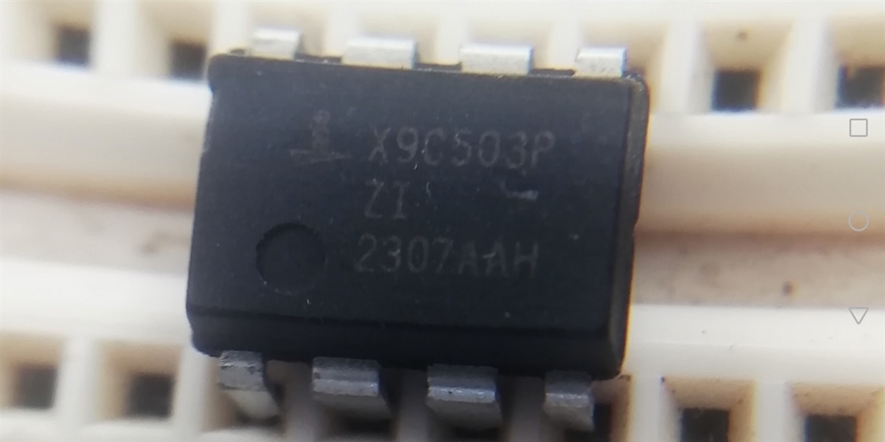

X9C503 works with ESP32?
Ricodora
Ricodora over 2 years ago
I can't get X9C503 to work with ESP32 but it can with Arduino Mega.
What do I need --> To be able to operate the X9C503 to lower the volume of an audio line input. I don't want to use common manual potentiometers.

In ESP32 if I connect it to the board it doesn't work, so I have used the 2N3904 diode for the 'INC', 'U/D' pins (I have also tried with 'CS' but Arduino Mega does it well being grounded), and It works but it doesn't do it well, I describe the problem:
You have to enter values between 0 and 99, and in general it does it well, for low values the volume goes down and for high values the volume goes up. I detected the problem by always entering the same value.
In this case it was '91', if I enter it several times in a row I get different results, normally the volume remains constant but sometimes it goes up, other times it goes down and even total silence occurs
With Arduino Mega I enter the '91' 500 times and the
The volume never changes, it is constant and its operation is always correct.
What could be the problem?

    0 shabaz over 2 years ago
    You've written a lot there. Long story short:
    You're using a digital potentiometer with up/down and increment pins. You're using some Arduino library called XC910X that accepts a value between 0 and 99 and it works with Arduino Mega, but with ESP32, sometimes the volume goes up or down if you repeatedly try to set the same level.
    First question for you: where did you buy the digital potentiometer from? If from ebay/aliexpress, it may be some alternative part (marked incorrectly) that might not operate well with ESP32 logic levels.
    If it doesn't work on ESP32, there's a fair chance the connections are not good (try swapping out the jumper cables, or try using a different breadboard for instance, or try three different pins).
    Alternatively, you could simplify, and directly control the digital potentiometer by configuring the GPIO pins yourself, and not using the library code, if it's not working for you. It's not a lot of effort since there are only three pins (CS, U/D and INCREMENT). You could put in delays, and observe with LEDs (if you don't have an oscilloscope) to see that the pins are functioning correctly. If that doesn't work, then I suspect you may not have the chip you think you have, and it could be a voltage level issue.
    A detailed photo of your setup will also help. Also a detailed photo of the digital potentiometer IC, if it was purchased from AliExpress or eBay.

    0 shabaz over 2 years ago in reply to Ricodora
    The Arduino Mega uses 5V logic levels, whereas the ESP32 uses 3.3V levels, so there's a chance that the digital potentiometer isn't functioning with 3.3V levels. Did you remove the transistors when it was working with the Arduino Mega?
    If it's a genuine X9C503 then 3.3V logic levels ought to work. However the X9C503 in the photo doesn't look normal (the left side looks like it has chipped just below the top corner). It's normal for a lot of AliExpress chips to be fakes (with a sanded surface, remarked) so the chances of getting a genuine X9C503 from there might be low.

  • Ricodora
    0 Ricodora over 2 years ago in reply to shabaz
    In Arduino Mega I don't use transistors. And in ESP32 I have to use transistors for it to work (without transistors it does nothing)
    I have always thought that it works at 5V, but... and if so... Why doesn't it work with transistors? I don't have much experience but for the rest of the ICs that work at 5V I use them with transistors and they work.
    It's from AliExpress, I think it won't be original, but another thing is that it doesn't work. In fact it works on Mega.
