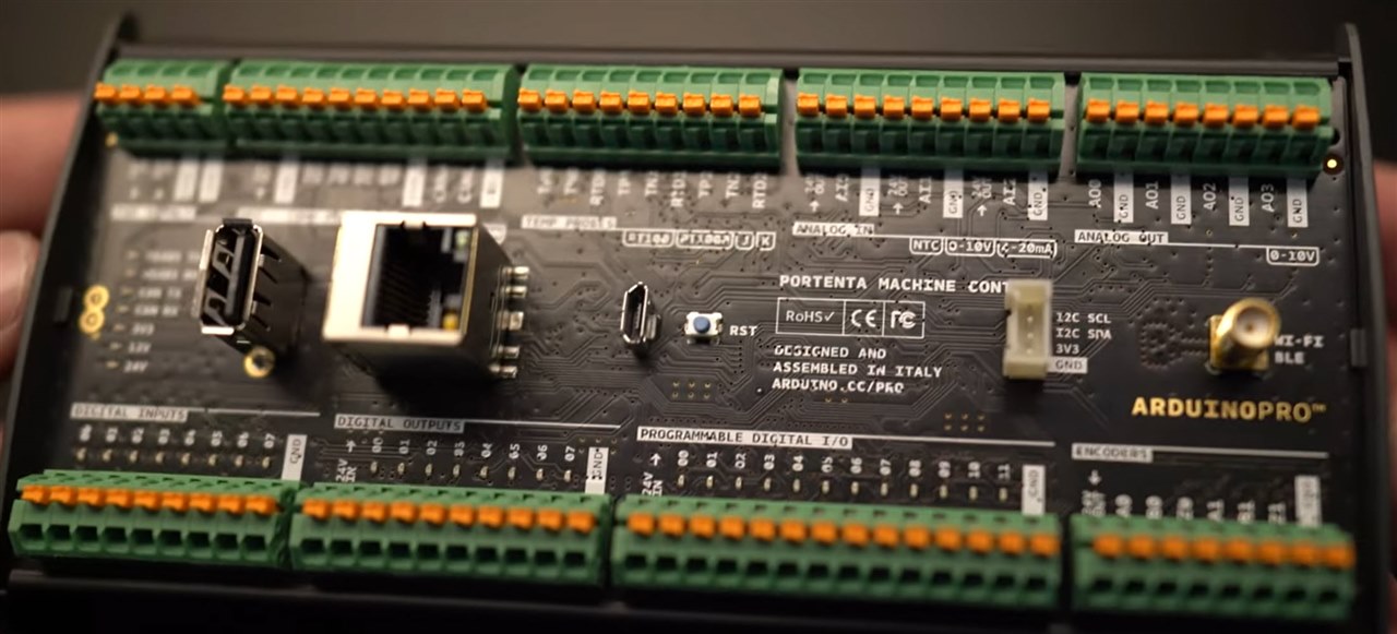

    shabaz over 1 year ago in reply to cstanton
    This is the render in the user docs, I thought it must be simplified, surely they would have some screws holding the boards together:
    However, no screws are visible in this photo from a video online.
    Underside photo:
    This device has thermocouple interfaces which are not isolated either, that's another accident waiting to happen.
    I could totally understand the device being used for experimentation, but the user docs don't say that; they suggest actually deploying the devices for real.
    Here's a board from possibly one of their competitors in this space, Advantech. They are using very large pin headers as interfaces between the control portion and the user connections. Plus the connections are isolated.
