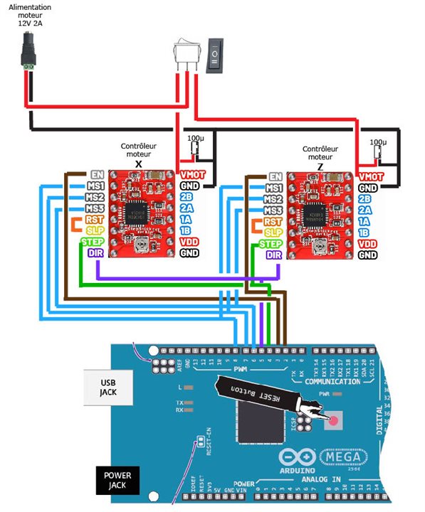

Hello everyone,
I want to slide a Raspberry Pi Camera Module 3 along the X-axis, then the Z-axis, to center it on the target subject for a time-lapse.
To do this, I have two CH-SM1545-M3xP0.5 micro motors (2-phase, 4-wire bipolar – 12V – with a threaded shaft travel of 80mm), and each will be controlled by its own A4988 motor controller. Selecting or powering on one of the two motors will be done with a KCD3 ON-OFF-ON SPDT 3-position toggle switch. Depending on the switch position (right or left), the target motor will be powered, while the other will be off. One of the powered motors will be controlled by a potentiometer.
Here is the electrical diagram for a single motor and its Arduino code. This works well with IR boundary sensors.
I have several questions about the electrical schematic.
I don't want to replicate my schematic for each motor. I'll end up with two 12V power supplies and two potentiometers for positioning the X-axis motor on the X-axis and the same for the Z-axis.
Can I power both A4988s with 12V via a third A4988?
Or should I place the toggle switch between the third A4988 and the other two, or is it possible to connect it directly to the Arduino Mega 2560?
Thank you for your time and ideas. I have little experience and am very curious.

    For the moment, I'm focusing on powering the two A4988s in parallel. I'm using two linear micro stepper motors: CH-SM1545-M3xP0.5 - 2 phases - 4 bipolar wires - 12V. In my first lab setup (see first…

    dougw 9 months ago
    The Mega has enough pins to connect both motor controllers at the same time. The switch can tell the Mega which motor to move with the pot.
    Both motor controllers can likely use the same power supply, just connect both in parallel. If the power supply can't supply enough power, you may need to use the motor controller enable pins to disable the controller that is not in use.

    Thank you for your reply.
    Here is the wiring diagram for two A4988 motor controllers.
    However, I'm not sure about the parallel connections for the 12V supply between VMOT and the 3-pin toggle switch.image
    Jan Cumps 8 months ago in reply to beacon_dave
    yes, with the additional disadvantage that the time to wait after VMOT is applied, is larger than the time to wait after asserting EN.
    ... and VMOT has to top up that 100 µF cap each time.
    Reasonable (and traditional) option is to have both active as long as the design is operational.
    There are reasons to do it different, but I don't see any need for that in coincoin_2026 's requirements.

    Jan Cumps 8 months ago in reply to coincoin_2026
    coincoin_2026 said:
    In my first lab setup (see first image), the motor stays in place once the power is cut.
    Yes, but you can move it by hand. It has no break power.
    If there is any weight on one of the two motors (or wind blowing on your camera, or camera not 100% horizontal), the motor will not hold it in place.

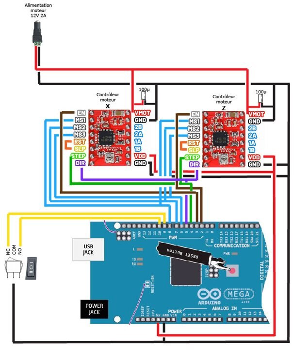

    yes, I don't think it's a correct approach. It's not a requirement, it's a (odd) implementation decision.

    I think I'm getting closer to the solution.
  • coincoin_2026
    coincoin_2026 8 months ago in reply to coincoin_2026
    Thanks for your help.

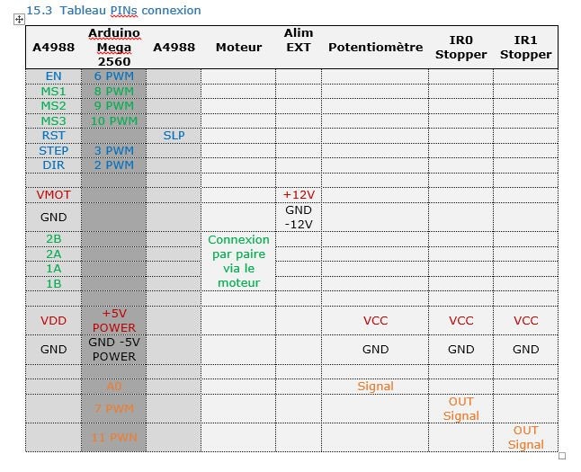

    I've made good progress. I've implemented the four optical sensors for the two bipolar stepper motors.
    Should I add a capacitor to the 5V output and GND of the Arduino Mega 2560? If so, should it be 100µF or 470µF?
    For visual monitoring, I want to add a pair of diodes (red = OFF -- green = ON) to each motor to indicate when it's powered on.
    Should I connect one diode with its 220Ω resistor between NC and pin 9 of the Arduino, and another NO diode to pin 10 of the Arduino?
