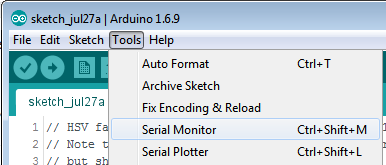

    Lastly, Can you explain to me how to view my arduino in a terminal window.
    It never works for me
    I read about it, and dont know why it displays nothing!
    mcb1 over 9 years ago in reply to toxsickcity
    As long as you have the Serial.begin(57600)
    You seem to have it twice Line 60 and 67
    and some Serial.print or Serial.println somewhere it should work.
    I'd add something like
         Serial.print("k :");
         Serial.println(((rgb[k] *bright[k])/256));
    to line 94 and 95
         Serial.print("k2 :");
         Serial.println(((rgb2[k] *bright[k])/256));
    to line 100 and 102 (or 104 and 106 as they'll become).
    which should show the values that are being sent to the rgb pins.
    I simply open the Serial Monitor
    It will remember the last setting, so I tend to always use the same (9600) for my sketches as they are generally in debug mode and not timing critical.
    Try my sketch and you should get something.
