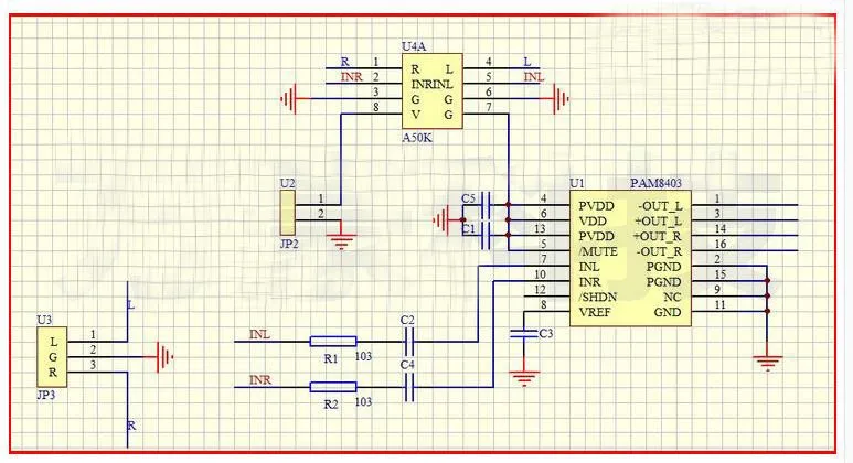

Hi everyone,
This is my first ever electronics project. I'm an IT infrastructure professional but as most of my kind, I only deal with servers, switches, routers, operating systems and so forth. I designed and breadboarded a simple fm radio with an Arduino UNO and I'm here to ask what I could improve before soldering everything together with an Arduino Nano.
Components (is it correct to call these 'active components'?):
  • Aruino Uno (despite what the scheme says, planning the use a nano for the finished product)
  • TEA5767 on an I2C board
  • A 2x16 LCD connected through an I2C board
  • XH-M177 speaker amplifier (with to 8ohm 0,5 W speakers) with a volume knob (PotMeter) which clicks off when rotated all the way left.
  • Rotary encoder for tuning
Edit: new scheme after recomendations. I stated that a 100nF capacitor was enough for the LCD not to go haywire when clicking off the volume button... that was incorrect, switched it back to a 100uF (I don't have any others).
I added one capacitor because the LCD would go haywire when I switched off/on the amplifier. What do you guys think about this scheme? I am going to add a simple on/off switch to completely turn of the circuitry when not in use.
I tried catching the off switch from the amplifier but power still seems to go through after it clicked off. I found one pin that still produced around 1V (in stead of 5V) but I don't know how to use that because it's still letting current through and a digitalRead would not be able to catch the 'off' action, right?
Edit: wrong: The threshold is about 0.3*VCC (= 1.5V when VCC = 5V) so that's enough to catch it. Maybe I'll put a resistor in place to be more certain... Changed the code accordingly.
Also, I don't understand the concept around pull-down and pull-up resistors. I watched the latest TBHS (BB8 with LED art) and he speaks about it but it's all a bit too fast for me. I really do want to understand it.
The code as it is below, feel free to comment on this too (edited this too after being able to catch the volume knob off switch state):

    shabaz over 8 years ago +2
    Hi Thomas, The SDA and SCL lines specifically either need a resistor (try about 4.7k) to +5v, or they should be omitted if the Arduino already has them integrated. There should be no resistors to 0V, which…
    Jan Cumps over 8 years ago in reply to hofa +2
    Ok. The module already has the required resistors. They are R2 and R3 on your drawing. I had a more stable encoder when adding a few capacitors. It takes care that the operation isn't jumpy and nervous…

    hofa over 8 years ago in reply to shabaz +2
    Thanks all! As I said: first time for everything I'm putting on here... I understand that I shouldn't change the original post but I certainly didn't expect this much reaction so my apologies for that…

    shabaz over 8 years ago in reply to balearicdynamics
    Hi Enrico,
    I'm sure you're right, some of my comments now make less sense since the original
    diagram has been modified by the author. There were originally pull-down resistors (10k)
    in the diagram, which could only have functioned if there were stronger pull-ups somewhere
    too (e.g. Arduino, but as you say that doesn't have them).
    I just didn't check if the Arduino had them or not (I didn't want to debug the entire project for him,
    but just mentioned any glaring errors like the pull-downs he originally
    had on the I2C bus (but the diagram doesn't have them now) .
    So I requested him to remove the pull-downs, check if it functioned (as you say, it shouldn't if
    there are no internal resistors) and then apply pull-ups.
    With the very unusual diagram style, and it is changing, it makes it difficult to now follow.

    Jan Cumps over 8 years ago in reply to balearicdynamics
    It worked on the breadboard. So maybe the difficulty that Thomas has is not building up the design, but translating it correctly to a schematic?
    shabaz over 8 years ago in reply to Jan Cumps
    Its another problem with modules.. we're left guessing whether the pullups are on some other board (could be Arduino [Enrico confirmed it isn't] or the LCD or radio module) because 10k could have been a weaker pull-down than the pull-ups, or as you say, a schematic drawing issue.

    hofa over 8 years ago in reply to balearicdynamics
    The XH-M177 is actually a module with a PAM8403 IC: https://www.aliexpress.com/item/Super-Mini-PAM8403-DC-5V-2-Channel-USB-Digital-Audio-Amplifier-Board-Module-2-3W-Volume/…
    The TEA5767 is the IC on the following module: https://www.aliexpress.com/item/Free-shipping-TEA5767-FM-Stereo-Radio-Module-for-Arduino-76-108MHZ-With-Free-Cable-Anten…
    XH-M177:
    I can't immediately find more info on the TEA5767.
