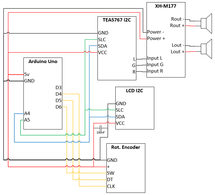

Hi everyone,
This is my first ever electronics project. I'm an IT infrastructure professional but as most of my kind, I only deal with servers, switches, routers, operating systems and so forth. I designed and breadboarded a simple fm radio with an Arduino UNO and I'm here to ask what I could improve before soldering everything together with an Arduino Nano.
Components (is it correct to call these 'active components'?):
  • Aruino Uno (despite what the scheme says, planning the use a nano for the finished product)
  • TEA5767 on an I2C board
  • A 2x16 LCD connected through an I2C board
  • XH-M177 speaker amplifier (with to 8ohm 0,5 W speakers) with a volume knob (PotMeter) which clicks off when rotated all the way left.
  • Rotary encoder for tuning
Edit: new scheme after recomendations. I stated that a 100nF capacitor was enough for the LCD not to go haywire when clicking off the volume button... that was incorrect, switched it back to a 100uF (I don't have any others).
I added one capacitor because the LCD would go haywire when I switched off/on the amplifier. What do you guys think about this scheme? I am going to add a simple on/off switch to completely turn of the circuitry when not in use.
I tried catching the off switch from the amplifier but power still seems to go through after it clicked off. I found one pin that still produced around 1V (in stead of 5V) but I don't know how to use that because it's still letting current through and a digitalRead would not be able to catch the 'off' action, right?
Edit: wrong: The threshold is about 0.3*VCC (= 1.5V when VCC = 5V) so that's enough to catch it. Maybe I'll put a resistor in place to be more certain... Changed the code accordingly.
Also, I don't understand the concept around pull-down and pull-up resistors. I watched the latest TBHS (BB8 with LED art) and he speaks about it but it's all a bit too fast for me. I really do want to understand it.
The code as it is below, feel free to comment on this too (edited this too after being able to catch the volume knob off switch state):

    shabaz over 8 years ago +2
    Hi Thomas, The SDA and SCL lines specifically either need a resistor (try about 4.7k) to +5v, or they should be omitted if the Arduino already has them integrated. There should be no resistors to 0V, which…
    Jan Cumps over 8 years ago in reply to hofa +2
    Ok. The module already has the required resistors. They are R2 and R3 on your drawing. I had a more stable encoder when adding a few capacitors. It takes care that the operation isn't jumpy and nervous…
  • hofa
    hofa over 8 years ago in reply to shabaz +2
    Thanks all! As I said: first time for everything I'm putting on here... I understand that I shouldn't change the original post but I certainly didn't expect this much reaction so my apologies for that…
    Hi Thomas,
    The SDA and SCL lines specifically either need a resistor (try about 4.7k) to +5v, or they should be omitted if the Arduino already has them integrated. There should be no resistors to 0V, which is how you've got them on your diagram currently. Double check your prototype, and if you have got them there to 0V, try removing them off the breadboard and confirm operation.
    Also, you possibly don't need that lower 100uF capacitor, again as an experiment on your breadboard remove that, and insert 100nF capacitor close to the supply rails of the LCD. The other modules are likely to already have a capacitor integrated on them.
  • hofa
    Thanks for the help! Putting resistors between the SDA and SLC lines and +5V breaks the whole thing, I guess they are incorporated in the UNO. I'll check out what happens on the NANO when I'm going for the finished product. Should I still connect the SDA and SLC lines to ground without a resistor or just omit those links? I guess they should be omitted or else I'd have a short-circuit?
    I made a mistake on the scheme, there was no capacitor close to the FM module but close to the LCD. I removed the lower capacitor (amp already has a capacitor: 470 / 6.3 V / UT) and replaced the LCD 100uF capacitor by a 100nF capacitor and everything runs as it previously did. Great stuff!
    I bought me one of those 'The Arduino Starter Kit' with some components and I was happy to find a non-polarized 100nF capacitor, didn't even know non-polarized ones existed (it's a .1J63).
    Updated scheme:

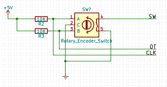

    Is the rotary encoder working ok? When I used one on the arduino I had to provide pull-up resistors (between the switch contacts and VCC, and debounce capacitors between switch contacts and ground.
  • hofa
    hofa over 8 years ago in reply to Jan Cumps
    I'm having a hard time deciphering what you're saying (as I said: concept of pull-up is not yet clear to me, going to read up on that + never even heard of debounce capacitors) but the rotary encoder I'm using is a Keyes KY-040 which is made for use with the Arduino. It's fitted on a small silicon board with resistors already attached and pins specifically for easy breadboarding:
    I did have some issues with it. I couldn't correctly register whether it was turned or in which direction. Some troubleshooting led me to believe that it was the bulk of my programming. I then added a system that evaluated the rotary encoder every cycle but not the rest of the code. That is now evaluated every 30.000 cycles which is about one second.
    I had a more stable encoder when adding a few capacitors. It takes care that the operation isn't jumpy and nervous.
    See my blog here on the forum:
    Rotary Encoders - Part 3: Capturing Input on an Arduino
    In your module, they would go between A to C and between B to C. I used 0µ5 (500nF) for each of them.

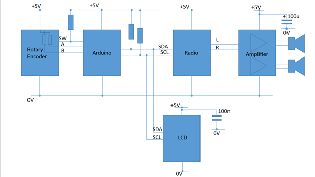

    Added question:
    Right now I'm catching the off switch on the amplifier with a digitalRead (still produces 1V) and the turning off the LCD and radio modules programmatically but I could probably do that with a transistor by attaching +5V to the drain and VCC of LCD and radio to the source and using the amp-switch-pin as gate.
    Actual question: should I use a MOSFET or regular transistor?
    Hi Thomas,
    Just a general point (the information from Dave and Jan still applies), I just wanted to focus on one thing here: the diagrams are quite hard to follow!
    It makes it difficult for you and others to figure out the areas that are ok, and the areas that need to change.
    Here is an alternative representation, it is still not complete and isn't perfect either, but is just to give you an idea on the style. It is better to go for this style of diagram rather than the above style.
    You can see that everything is read from left to right (inputs like the rotary encoder are on left side, audio output on right side), and no need to use the half-circles to show where there are no connections, you can use a solid circle to define connections. The supply rails can be labelled as such, and shown at top and bottom, with the +5V at top, and 0V at bottom.
    The general style of diagrams can be seen in electronics text books, it will also explain the pull-up thing and how to connect switches (which is what your rotary encoder is made of internally) to the Arduino. For some good ideas, please see here: I Want to Do Electronics!  Where do I start?
    The books will also address how to use a MOSFET or other transistor (I am not trying to pass off a simple question, the point is the answer is detailed, needs some reading to do it justice, whether that is from a website or from a book). The MOSFET or transistor will need additional components, and again you'll need to know what a pull-up or pull-down does as well as some other things.
    Note that for this particular scenario there is no need to do a controlled shutdown, a normal mechanical switch can be used to power everything off or on from the +5V supply; no need to send a signal from the Arduino to shut down things separately.
