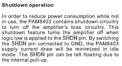

    The datasheet here suggests you will need a good capacitor across the power supply.
    PAM8403 pdf, PAM8403 description, PAM8403 datasheets, PAM8403 view ::: ALLDATASHEET :::
    You have access to both MUTE and SHUTDOWN so maybe you could achieve the same using one or both these pins.

    Thanks for finding that but it seems that the SHDN pin is omitted on the module I have (XH-M177 diagram) and I'm not planning on soldering right on the IC, my soldering skills are not on par. Also seen on the diagram: a bunch of capacitors (C1 through C5?) of which C1 is a 470 UT (= 470uF) 6.3V. Thank god for those modules or it'd be weeping in a corner by now...
    mcb1 over 8 years ago in reply to hofa
    It does look that way from the image.
