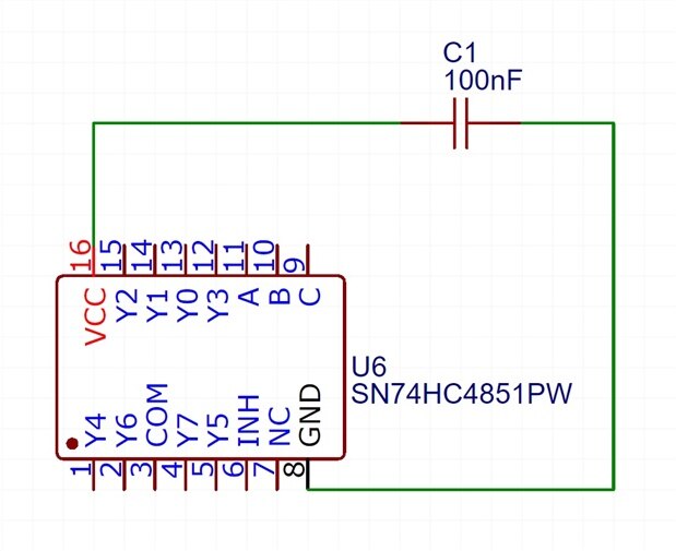

    https://easyeda.com/editor#id=63924b08d02d44fc9a50f9f875a0448c here is a compleated schematic that's finished from what knowledge iv attained the remaining open pin are all inputs 8 inputs per multiplexer so positive of the piezo goes to a multiplexer pin and the neg goes to ground if im not mistaken please correct me if im wrong and also let me know if this circuit will work

    shabaz over 9 years ago in reply to ashleymosey
    Hi Ashley,
    It looks about right if you're trying to replicate the design, although you're missing 1M resistors between pin 3 on the multiplexer ICs and gnd.
    I'm not sure you need R1 (the resistor connected to Reset on the Arduino) since the Arduino standalone runs fine without this.
    Also, you're missing the connectors to which you will wire your inputs.
    And it is a good idea to add 100nF capacitors across the VCC and GND pins of each of the '4851 ICs.
    Also, the original circuit diagram is ugly, I can understand you're trying to replicate it so it has been entered in a similar way, but for future designs it is best to stick to some conventions (VCC drawn at the top as a horizontal line, GND at the bottom, inputs on the left, outputs on the right).
    Also the piezo issue that dougw mentions should be considered too.
    Finally, it's good you're designing your own board. 20 euro + 10 euro shipping for it is extortionate as far as I am concerned.

    If I'm honest i dont know what resistor 1 to the reset is for I just kinda followed the trend of what other people did, and iv now fixed the resisters from the IC to gnd, and i just left the connectors out for now I just know that all the remaining connections are for Piezo possitives and the negatives go to ground if I'm not mistaken ?? I'm not sure what you mean with the capacitor across the VCC pins and GND they aren't connected already are you suggesting I connect them like so: image
    Hi Ashley,
    Exactly as you've drawn, close to each IC. See figure 3.3.2 here:

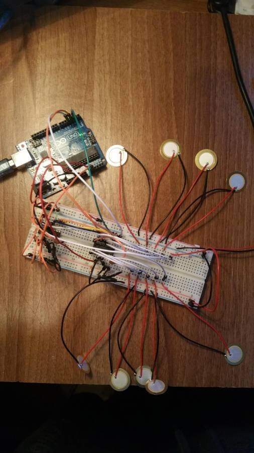

    So i though it would be nice to give you guys an update on where i am seen as you were all kind enough to help me, and i didn't want you thinking your advise had gone to waist. SO iv just as I'm writing this post finished rebuilding the Prototype on a solderless breadboard, i rebuilt it again because i though i may have done something wrong but I'm more lead to believe the issues i now have are software related. if you had a much time to dig around on forums to figure this thing out you'll understand that the original creator was fairly lazy on instruction on how to build this Drum machine, although in fairness he has done a lot of work else where E.g software circuitry but then there no supporting documentation that is fully fledged enough to understand, im at the point now where the software is recognising when i hit the Piezo's but i get the same comm input on the monitor with the software and the software keeps crashing which doesn't help. anyways il try not to blabber on too much as i don't want to bore you guys to death with that unless any of you have put together one of these before and know how it works. anyways
    anyways here's a photo of my solderless breadboard my first ever one so don't judge too much although any pointers, advice or even good practices i could use to make my prototype a lot more organized
    And once again thanks guys for helping me already
