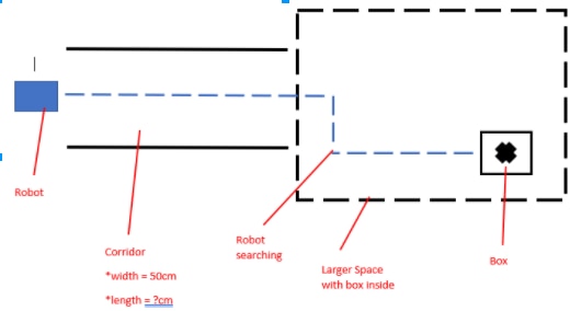

Please help doing a project and trying to improve my skills with this new robot kit
i got with a few sensors (Robot: Magician Chassis Robot)
Task: make a robot that passes through a corridor first with a width of 50cm that then enters a larger space where the robot must search and find a box
Sensors: ultrasonic and IR sensor
I have managed to get the robot to pass through the corridor without touching the corridors by attaching ultrasonic sensors on each side of the robot
but now I am trying to get the robot to search and find the box after it first enters the larger area I was told this might be a "collection of distances" problem
but I have no idea what that means and how I would go about programming or creating an algorithm (easy flowchart) for
Please help thank you !!

    What you need to do is check the room and collect the distance readings where you will find some that are a closer than others indicating there is an object is in the path.  This distance should be less than the wall behind it so once you have this you can focus the bot on moving toward the object.  Then at a close distance you would stop in from of it.  This might be best with the ultrasonic sensor and use the IR sensors to keep the bot from hitting the walls.

    how would I code this if you dont mind helping? and in the case for example if some parts of the wall are closer than other like a maze for example and is not an nice and easy shape shown in the diagram would the robot think that the closer parts of the wall in the object out of interest?

    You have a few choices.  You could use the Ultrasonic Sensor to sweep the room and collect that data in a data structure such as an array and look for the value(s) that is not consistent with the others.   The walls will have a consistent set of values depending on whether or not they are closer or far away.  The object will be the inconsistent value and should stand out from the others.   You can do this if you have the Ultrasonic Sensor on a servo and sweep from left to right.  If that is not an option , then you might have to move the bot from left to right collecting the data.   The IR sensors could be used to detect if you get close to an object such as a wall.
    The other option is use the Ultrasonic Sensor to keep track of the wall distances and the IR sensors to detect when you reach an object.  If the IR sensor detects an object that is closer then the wall distance, then you can determine if you have reached the object or not.  In this case, the ultrasonic sensor would be mounted higher than the IR sensors.  If the object is small, then this might be the best option.  In this case, you will have to calibrate both sensors to get an idea of what values determine an object or a wall.
    You'll have to play with the ultrasonic sensor to determine how it senses when an object in the path vs when it detects a wall.

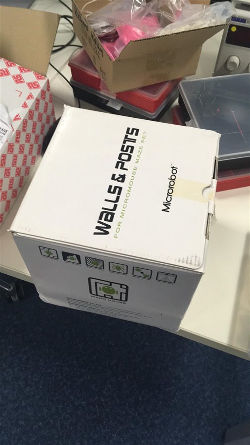

    last question thank you for being so helpful in the event that the box is in a larger vast space without any other objects besides a chair how would the robot know
    the different from the box and the chair the box is the white box in the image image

    Well, a chair has many definitions; it could be a bean bag, a rocking chair or a standard 4 leg chair.  In the case of a standard 4 leg chair, the leg of a chair will have a much narrower detection area than the box does.   In the case of the Ultrasonic Sensor, the leg will only be seen in a very specific area of the sweep.  the box will have a much wider area of sweep.   With the IR sensors, if you are using an array of IR sensors, the chair will only show up on something like 1 or 2 sensors, where the box will more likely show up on more than 2.
    My suggestion is that you put together an IR and a Ultrasonic sensor circuit and see how they indicate when an object is in front of them.  If you are using an IDE that has debug capabilities, then you could set a breakpoint where the senor is read and use a variable to add to a watch list.  Then just loop through reading the sensor with and without an object in its path to see the difference in the reading.  If you are using something like the Arduino IDE, then you can use the serial output to send the data to see how the values change.
