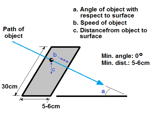

Hi all,
I am discussing a possible project, but I am not certain how feasible it is. The project consists of using an Arduino, plus some sensor (or sensors) to measure the speed, angle and height of a flying object over a 6 x 30 cm surface. Although I am unfamiliar with the details, the object will pass over the surface and the Arduino needs to get how fast it is moving, the angle at which it crosses the surface and the distance from the surface to the object.
I posted a rough sketch below.
Can some one please provide some feedback as to how feasible this is and what sort of sensor(s) will be needed? Thanks! Salvador

    Hi Bhavik! Thank you for your reply. The object is a tennis ball traveling at approximately 70 to 90 miles per hour. Salvador

    The object: A free flying tennis ball travelling at approximately 70 to 90 MPH (110 - 145KPH) always on a positive slope
    The budget: $50 USD
    The math is interesting. I am looking for three measurements. The height can be taken care of with a distance sensor on the surface, measuring the distance as the object flies over head. The angle can be calculated by taking various height readings at different points of the surface and then calculating the slope and getting the angle. I'll admit my trigonometry is rust, but nothing some research can't fix :-). The speed can be calculated by the time it takes the ball to go from one height sensor to another.
    Still, given the answers to the questions I've asked so far, to me it seems that it might not be doable. 70 - 90 MPH is fast and as you mentioned the 16MHz is a limitation. At the ball's speed, I am not sure if the device can take even one valid reading!
    At this time I have only been concerned about the data acquisition, but your other design questions are very valid. What needs to be done with the data once it is acquired? I am going to ask that too, but have not because I have doubted the project's feasibility from the beginning and given the above parameters I am not sure it can be done with the intended hardware or budget.
    Regards, Salvador

    Must it be a normal tennis ball or can you modify it ?
    How quickly must you come up with the result  after the ball passes ?
    A vision based system is the obvious choice.
    At 145kph = 40.3m/s the ball will take 1.489 ms to travel 6cm so you will need  a camera operating at 2000 frames per second or faster - lots of money.
    Possibly, if the ball is always traveling fast, you might be able to use microphones to listen to it (this approach is used for tracking bullets) - you can't detect  slow tennis ball be sound because it is too quiet.
    Leading on from this - perhaps you could "illuminate" the ball with modulated ultrasound and use several sensors to estimate its position.
    The passive sound based idea could be cheap (for the sensors) but would need way more than Arduino processing power - but might get within $50 if you made 100k of them.
    Active ultrasound would cost more  - unless you can train bats image
