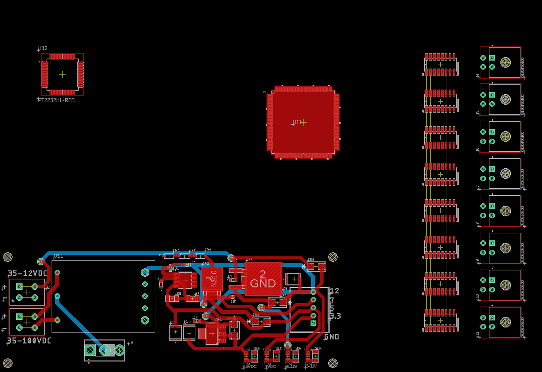

Does anyone here have any experience with this topic?
I`m going from a TUSB2077APTRTUSB2077APTR controller to two FT232RL-REELFT232RL-REEL IC`s just to test this prototype idea.

    It looks as if you want an Arduino with 8 RS232 ports. The neatest way to do this is to use an FPGA - something fairly small will do. You can connect the FPGA to the Arduino via UART or SPI at logic level…

    "The idea is to connect 7 RS232 connections. Then access them via Arduino (or similar type proto board) in the end." Perhaps take a look at the ATxmega A1U or A3U family of AVR 8-bit microcontroller which…

    Well you have thrown a wrench into my plans.....
    But after looking at things a FPGA would be a nice solution that we could use in other applications (RS485 for example)
    Im looking at the Lattice XP2.
    In the end the circuit will look a little like this.
    Sure simplifies what I had already started using the conventional method. This will reduce the cost and IC count for sure.
    I`m going to buy the proto board to get things moving. In the background I`ll create the PCB and maybe intigrate the CPU.

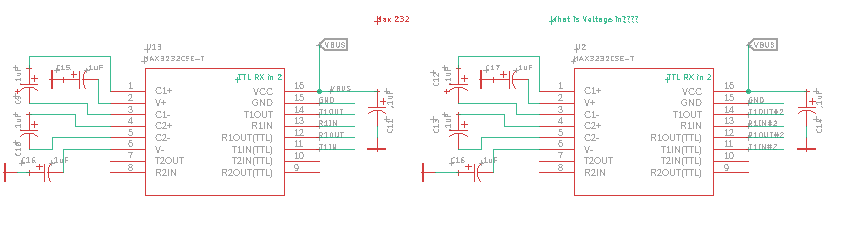

  • abrain
    abrain over 7 years ago in reply to s1buell
    Looks like you're making some progress Tom - am I right in thinking you wanted separate grounds though for the serial ports?
    If you want isolated ports, I've used onto-isolators in the past for the Tx and Rx signals, and a dc-dc convertor to isolate the power supplies for each channels MAX232 chip. You need to be wary of the speed of signals through the opto-isolators (limited myself to 2400baud once.... don't want anyone to repeat that mistake! image).

  • s1buell
    s1buell over 7 years ago
    abrain
    Yes I need separate grounds for sure.
    • Did you mean opto-isolators?
    • I will look at that link for sure

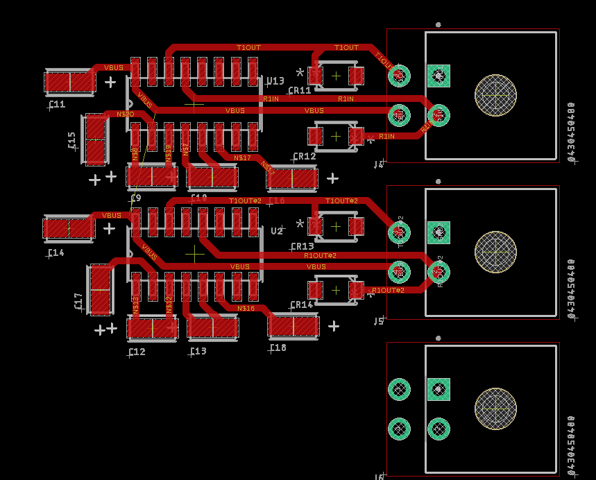

  • s1buell
    Well I started to setup the model for the RS232
    Then after a morning meeting the project was cancelled.....
    I`m a little sad. I was looking forward to building an FPGA...... Maybe next time.

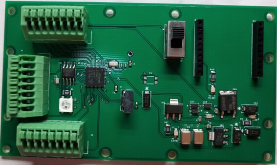

    You guys (anyone) interested in building an industrial CPU? I already have the proto board produced but I still have lots to do and extra eyes are always welcome.
    I would love some more experience on this one.
    I really need someone to make me some firmware…. Lol

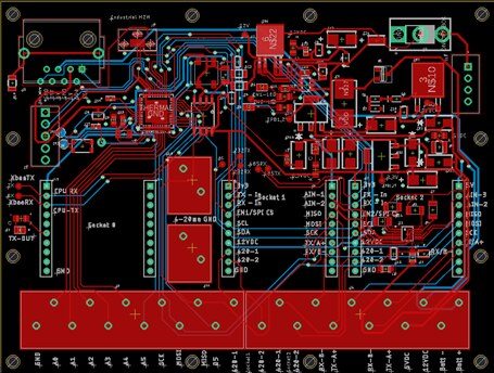

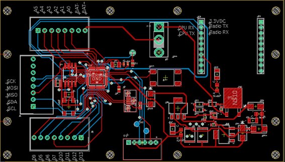

  • s1buell
    • I wanted to start off with some simplicity and then evolve into a full industrial board.
    • I used the ATSAMD21G18 this processor is great (in my view) for IIOT applications
    • I love the sercom`s and the two internal DAC`s
    • I also made it Circuit Python capable (I think)
    The other idea I have is to componentize the architecture making easy to change processors or sensor communications  etc. That is why you see the power supplies very separate from the CPU
    After proving the concept, I will make it much more appealing to the eye. I like space and lots of test points when proving concepts
    I did evolve it into a concept board already.... To much Coffee! (not produced). Need to prove the basics first.
    That get your interest?
    Anyone work with this CPU before? I`m having a *** of a time with the boot loader and firmware?
