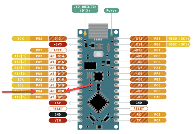

Can someone illustrate -or- point me in the right direction on how to manipulate port registers in the Nano Every (ATmega4809)?. - I'm using the Arduino IDE
The port manipulation described here for the ATmega328p/ATmega168 works as follows and works well for me in the Arduino Pro Mini and ATmega48;
DDRD |= B11110000; // sets ATmega digital pins 7 to 4 as Outputs
PORTD = B10010000; // sets digital pins 7,4 HIGH
When I try the equivalent with the Nano Every (ATmega4809) it seems the pin mapping is completely different
VPORTD.DIR |= B11110000;
VPORTD.OUT = B11110000;
I'm using bit-wise operations as my plan is to replicate the same in the Nano Every without emulation -if possible- so I can manipulate many digital/analog pins at once with one instruction (avoiding having to do it for each GPIO at a time)

    Hi Luis, It should be the same, however the pins would be the Port D pins for bits 4-7, which won't necessarily be labelled D4-7 on the Arduino. For example, the port D bit 4 is labelled D20 (see the red…

    Thank you Shabaz, it worked as you described!. It was a bummer for me that the pins are all spread and couldn't managed to find a quantity enough grouped under the same register for my intended use. Thanks…

    Hi Luis,
    It should be the same, however the pins would be the Port D pins for bits 4-7, which won't necessarily be labelled D4-7 on the Arduino. For example, the port D bit 4 is labelled D20 (see the red arrows in the diagram below). So setting Port D bits 4-7 would actually set D20, D21, AREF .
    I have not got an Arduino Every so this is just based on what I'd expect to occur though.
    Thanks a lot for your help.
    Luis

    0 Leopard347 over 2 years ago in reply to shabaz
    But there is no PD6
    0 shabaz over 2 years ago in reply to Leopard347
    I'm not sure what the issue is, it's normal for boards and even microcontrollers to be missing certain GPIO pins: not all need make their way out to physical pins based on the type of package. The register addresses often still reference those absent pins, it is up to the user to ignore those bits in the registers.
    I've not used this microcontroller or board, and I'm mobile with no easy access to the datasheet, so I could be totally wrong.
