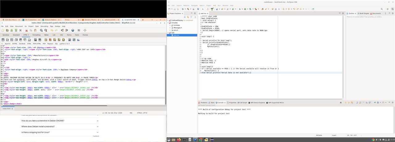

    Some IDEs will catch that, it's a shame that the Arduino IDE is quite basic. This is CLion:
    (EDIT: just realized my 'bob' example is not quite the same)
