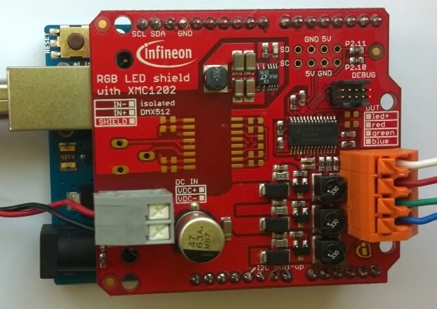

Compare the Infineon RGB libraries that spawned from the Internet of Holiday Lights
The Internet of Holiday Lights RoadTest Plus has generated at least three libraries for the Infineon RGB LED Driver Board.
Robert Peter Oakes lib: BYOB Party #3, Infineon Library Available
ipv1 lib: [Dynamic Living-Room Lights] The Infineon RGB LED Shield -Library!
beavertank lib: IoT Christmas Ornaments - The Software, Part 1
I've tried Robert Peter Oakes's library, but I'd like to run all of them and check if there's something to learn out of it. It would be great to find out that the same problem is solved in more than one inventive way.
It's a working document. Feel free to join.

Getting started:
Easy. I followed the setup instructions and the shield worked right away with the example.
Sketch size:
Sketch uses 4,794 bytes (14%) of program storage space. Maximum is 32,256 bytes.
Global variables use 404 bytes (19%) of dynamic memory, leaving 1,644 bytes for local variables. Maximum is 2,048 bytes.
Tested with this minimal program that does the setup and calls the method  RGBLEDS.SETCOLOUR().
That takes care that the library's main functions are all linked in.

It's obvious from the review that all three libraries are easy to use. The differences between them are low.
All three make the start easier than the example of the Infineon Quick Start Guide.
And all allow you to use the important features of the board with a nice layer of abstraction and encapsulation.
I used the libraries to get my device running before I fully understood the shield.
That is my prefered way of learning.
I prefer having a working example that I can probe and play with, and dig into the details and principles behind it while having it on the bench. I'm quite poor at reading datasheets without having a running example.
Once you have the shield working with one of the three libraries, it's a good time to step a level down and look at the Infineon example and the explanation of the shields operation.
Next step may be to try and understand the on-board controller.
That's the end game of the board. It's there to drag you into Infineon's XMC1200 processor family and its LED driver module. Once you get to know how to use it with the Arduino, this is a great step to try and plug in a programmer and get the board working on its own.
A good starting point is shabaz 's RGB LED Shield from Infineon - Getting Started Guide.
