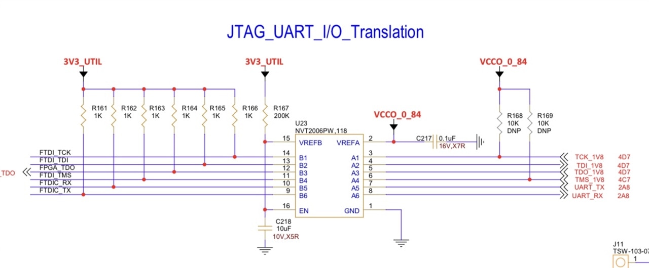

    U23 translator even though rated for the solution doesn’t behave well as temperatures increase.

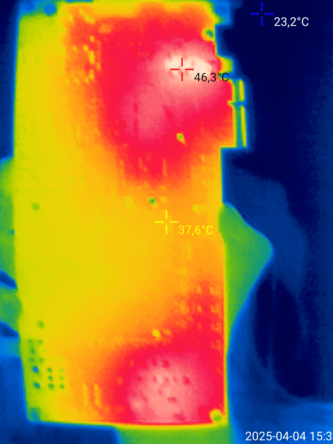

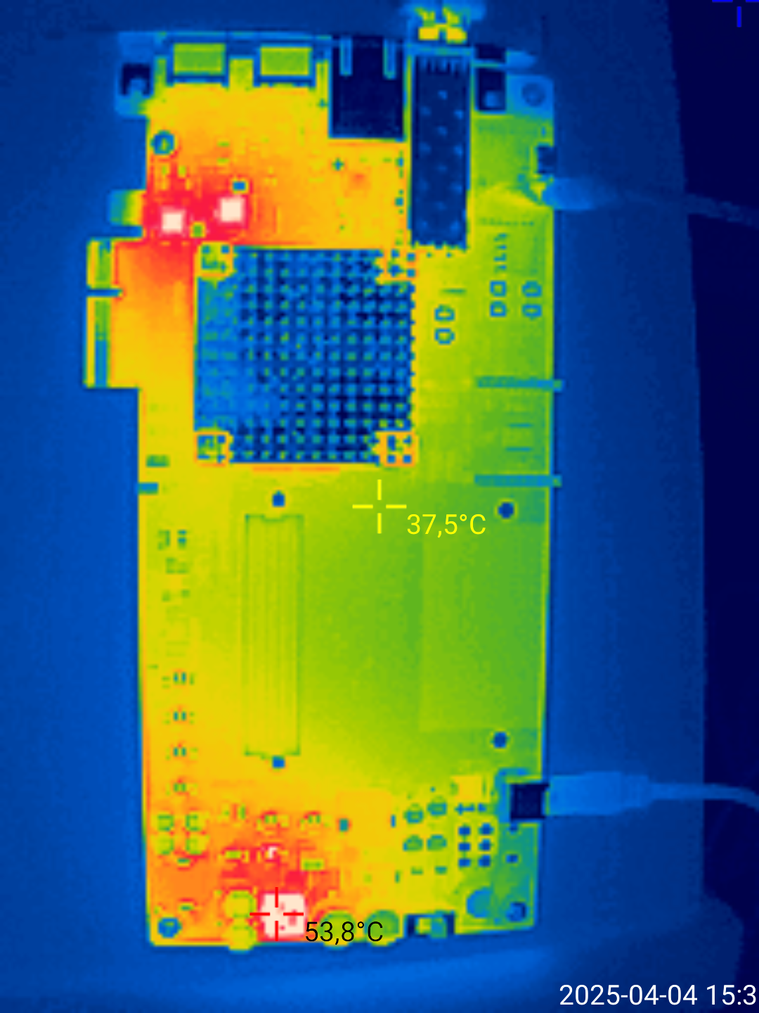

    Bott side E0,95top side thermal E0,95

    michaelkellett over 1 year ago in reply to iksevas
    Interesting - from your schematic the NVT2006  appears to be translating between 0.84V and 3.3V logic levels. The chip is now obsolete but was rated by NXP as being suitable for operation at no lower than 1.0V on the A port.
    I didn't look hard but I couldn't find a 6 bit level shifter that can do 0.8V to 3.3V !
    Rather makes you wonder why on earth AMD/Xilinx didn't put a level translator inf the FPGA on the JTAG port, and even more why Avnet didn't put the effort into a work around on the board.
    MK
  • iksevas
    iksevas over 1 year ago in reply to michaelkellett
    That is VCCO for bank 0 and bank 84. Translator is performing 1.8V to 3.3V translation.
  • michaelkellett
    Woops !
    Sorry.
    MK

    I’m seeing the exact same issue. Once the FPGA reaches around 45°C (Measured via SYSMON), the JTAG connection becomes unstable—Vivado keeps disconnecting and reconnecting, making any meaningful debugging practically impossible. I have used Vivado Lab Editions 2024.2 from Windows11  (Latest One).
    For context:
    • Ambient temperature is around 22°C.
    • A 120mm fan is actively cooling the entire board from top.
    • Despite these measures, the issue persists consistently under heavy load.
    • Clearly going to be more critical in the summer.
    What I see as a temporal solution is to reduce the design's power (IE keep DDR4 in reset) - This is not a viable solution for my application,as I do need to use this interface. I dont have a thermal camera to provide any images. I highly doubt that AVNET engineers did not see the same behavior during initial board evaluation (Unless they are working in a freezer).
