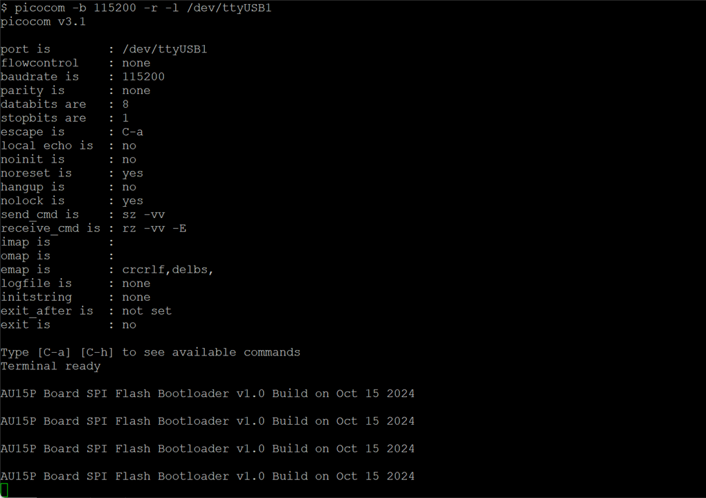

Hello,
I would like to inquire about the abnormal behavior of my AUBoard. Suddenly my AUBoard is not working properly, even the OOB reference design is not working.
After power cycling the board, the SPI Flash OOB design should be written properly, and the blue DONE LED should light up. The terminal should display "AU15P Board SPI Flash Bootloader v1.0 Build on Oct 15 2024," but it didn't progress to the next message: "Boot application AU15P_OOB.elf."

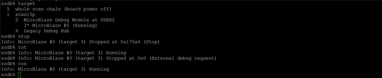

With XSDB, MicroBlaze appears to be running, but when I use the stop/rst/con commands, I only see the "AU15P Board SPI Flash Bootloader v1.0 Build on Oct 15, 2024" message, and it doesn't progress any further.
When I press the RESET or PROG_B push switches, the same message appears, but nothing else happens, as shown in the attached file.
The OOB was working fine when I followed the Getting Started Guide, but it stopped working suddenly.
I suspect that MicroBlaze is not allowing the elf file to work properly.
Please let me know what I need to do or investigate to resolve this issue. Any advice on this would be appreciated.
