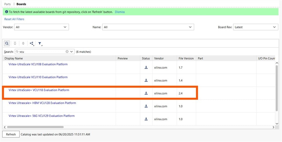

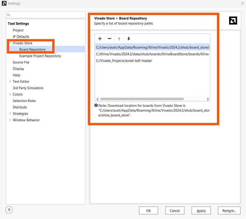

I recently purchased the AUBoard 15P FPGA Development Kit, and I want to set up my Vivado 2024 installation so that it can recognize this development kit. I downloaded the board definition files from the Avnet Github page (https://github.com/Avnet/bdf), but Vivado isn't listing the AUBoard 15P board as an option for new projects.
Fix attempt #1:
Vivado lists this location for board definition files for version 2021 and up, so I added it to my list of board repositories, but Vivado still isn't doesn't list the board as an option, so I can't select it when creating a new projecft:
<Vivado Install>\<Vivado_version>\data\xhub\boards\XilinxBoardStore\boards\Xilinx\
https://adaptivesupport.amd.com/s/article/The-board-file-location-with-the-latest-Vivado-tools
Fix attempt #2:
I found an article that creates an AUBoard project using Vivado by first creating a project from a VCU118 evaluation board, and then changes the target board to the AUBoard. I am unable to create a project using the VCU118 evaluation board, because after I download it, it disappears from the list of selectable boards:
www.hackster.io/.../4k-at-60hz-not-a-problem-with-the-auboard-b232b6
I need help to get Vivado to recognize the AUBoard, so I can create a new project. If anyone can provide any insight as to what might be going wrong here, I would be extremely grateful!
