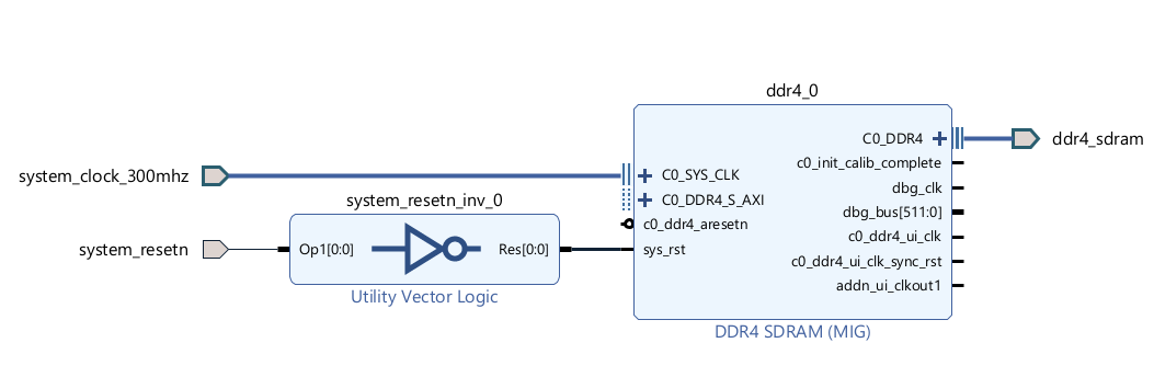

    The 300MHz system clock is tied to the DDR4 interface. image
    The BDF does not implement this standalone. It is not a problem. It is merely how we intended to operate with it.

    I understand this is intended for the DDR interface, and works well in IP Integrator when instantiating the DDR interface.

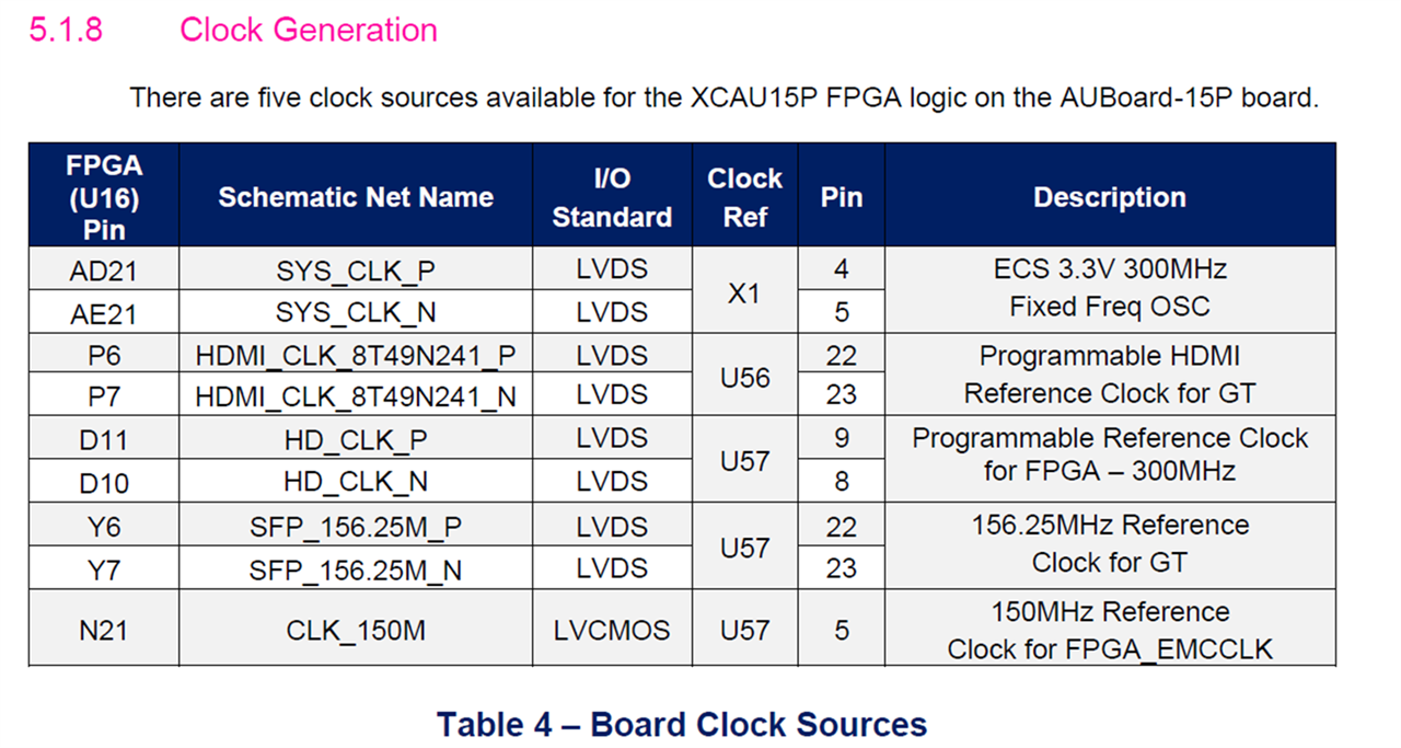

    Question is which clock should be used as "general purpose FPGA system clock for designs without DDR"
    Say for example I want to create a MicroBlaze design and generate a 100 MHz system clock for the Microblaze system - from the AUBoard user guide we have these clocks:
    I guess it should be the first or the third clock, both are 300 MHz, and both are not really working with the IP integrator automation, as explained in the former of this post.
    Of course we can workaround by manually modifiyng, constraining and specifying these clocks, was just to signal that the ready-to-use automations are not working for this usecase, that I see as a quite common one.

    Gianluca- Unfortunately, every use case of the design automation cannot be implemented and I apologize for that. As far as a user clock, there are two good targets on the AUBoard. The first is the SYSCLK_P/N particularly if the DDR is unused. Also, you can use DDR and generate clocks from the DDR core to be used by the FABRIC. The frequency of this generated clock is somewhat limited. As a result of this limitation on the available frequencies, we added the HD_CLK_P/N pin pair. This is a programmable clock from a 8T49N241 device. A user can program this clock (there is a reference design on the AUBoard webpage showing them how) to feed an MMCM that they can then use to generate a myriad of fabric clocks. So, there is flexibility in which clock a user may want to utilize. The SYSCLK_P/N is simpler in that you don't have to program the clock.
