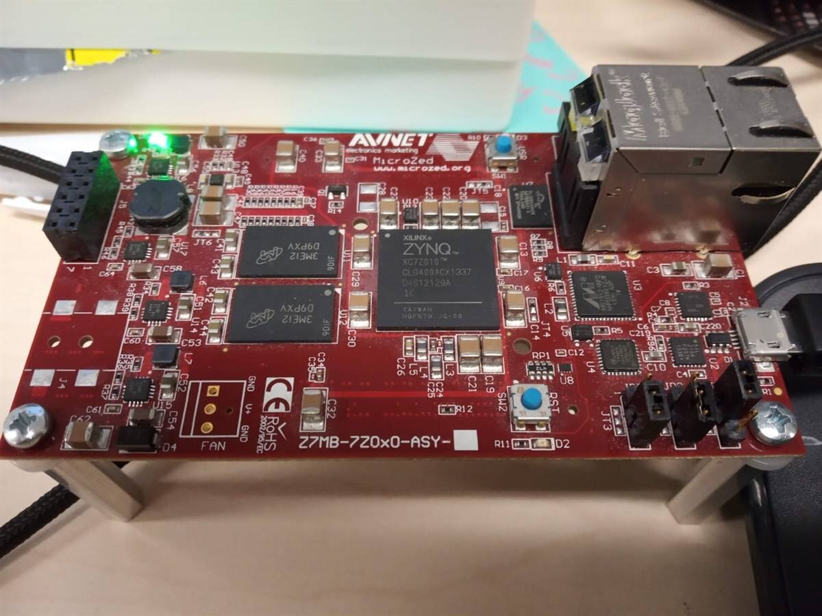

I am starting with the AVNET MicroZed evaluation kit and my first goal is to boot the linux using the pre-existing image.
I have followed the readme.txt and I have copied the following image http://www.microzed.org/sites/default/files/design/microzed_7010_7020_petalinux_SD_images.zip
7010 to my SD Card boot folder. I have formatted the SD card with FAT32 File system as per the documentation. Here is the picture of my jumper settings. However, on pressing the reset button
I don't see the linux or any log messages on my putty console. If I change the jumper setting to boot mode I see some errors - FSBL error. Here are the settings. I am doubtful if my linux images are correct or not.
Also, if I am missing anything more.

    There should not be a boot folder on the SD Card. You need to have the 7010 versions of boot.bin and image.ub located on the SD Card root directory. They must be named "boot.bin" and "image.ub" exactly.
    Bryan

    dexterous.me82 over 6 years ago in reply to bhfletcher
    Thanks, that works!
