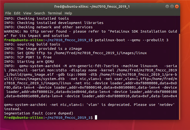

It's great to see an update to the BSPs for the Microzed and other boards. I'm trying to get to grips with Petalinux for the MicroZed and it seemed a bit odd that until recently the latest BSP was for 2018.2.
I'm still having issues with the 2019.1 MicroZed 7010 BSP and I was wondering if the problem is likely to be the BSP or Petalinux installation. I eventually managed to install Petalinux successfully on a clean Ubuntu 18.04.3 LTS VM. (There a few tweaks to the UG1144 guide I needed but I eventually got there.)
I've copied mz7010_fmccc_2019_1.bsp over. I successfully ran
petalinux-create -t project -s mz7010_fmccc_2019_1.bsp
I was trying to follow the simplest route to check petalinux is working as intended by following https://forums.xilinx.com/t5/Xcell-Daily-Blog-Archived/Adam-Taylor-s-MicroZed-Chronicles-Part-54-Peta-Linux-SDK-for-the/…
I then cd'd into the newly created mz7010_fmccc_2019.1 folder and ran
petalinux-boot --qemu --prebuilt 3
Any ideas? Am I using the BSP correctly? Is my Petalinux installation OK? I'm not sure where to go from here and google didn't help much either.

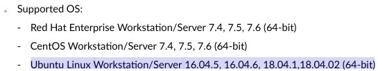

    I notice you mention you are running PetaLinux 2019.2 on an Ubuntu v18.04.3 host.  Technically this is an unsupported OS.  Xilinx UG1144 states that "Ubuntu Linux Workstation/Server 16.04.5, 16.04.6, 18.04.1,18.04.02 (64-bit)" is supported:
    This may or may not be your issue, but we have seen strange failures happen when later Ubuntu versions (v18.04.3, v18.04.4) are used.
    It may also be a strange qemu error.  I must admit I rarely use qemu, so I am not much help here.  A quick "petalinux qemu 'vlan' is deprecated. please use 'netdev' instead" Google search turned up this:

    2) The vlan is deprecated message is resolved by using the "exact correct" host Ubunutu version.  In may case I was using 18.04.4 but I should have been using 18.04.2.

    INFO:  qemu-system-aarch64 -M arm-generic-fdt-7series -machine linux=on   -serial /dev/null -serial mon:stdio -display none -kernel /home/charlie/pz7010_fmc2_2019_2/build/qemu_image.elf -gdb tcp::9000 -dtb /home/charlie/pz7010_fmc2_2019_2/pre-built/linux/images/system.dtb  -net nic,netdev=eth0 -netdev user,id=eth0,tftp=/tftpboot -net nic -device loader,addr=0xf8000008,data=0xDF0D,data-len=4 -device loader,addr=0xf8000140,data=0x00500801,data-len=4 -device loader,addr=0xf800012c,data=0x1ed044d,data-len=4 -device loader,addr=0xf8000108,data=0x0001e008,data-len=4 -device loader,addr=0xF8000910,data=0xF,data-len=0x4
    Segmentation fault (core dumped)

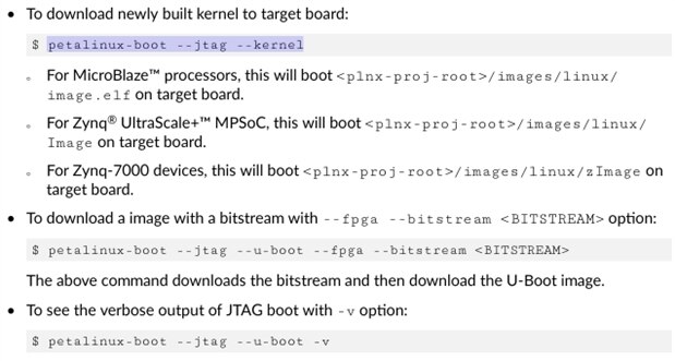

    Here is where I admit that I have never had much luck using the PetaLinux 'petalinux-boot --jtag --prebuilt 3' command and I don't often use qemu.  I normally do a test boot on mICROzED using JTAG:
    $ petalinux-boot --jtag --kernel --fpga --bitstream ./images/linux/system.bit --verbose
    The caveats to JTAG boot are that a)you have to physically have the target board connected via JTAG and UART and b)this works best if the OS image (kernel + rootfs) is small.  Both of these can be met with the MicroZed.
    As far as using qemu goes, you might try searching/inquiring the Xilinx forums.  A quick "prebuilt 3 qemu segmentation fault" Google search turned up these links:
