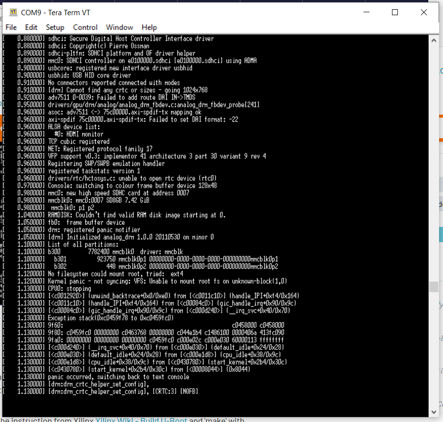

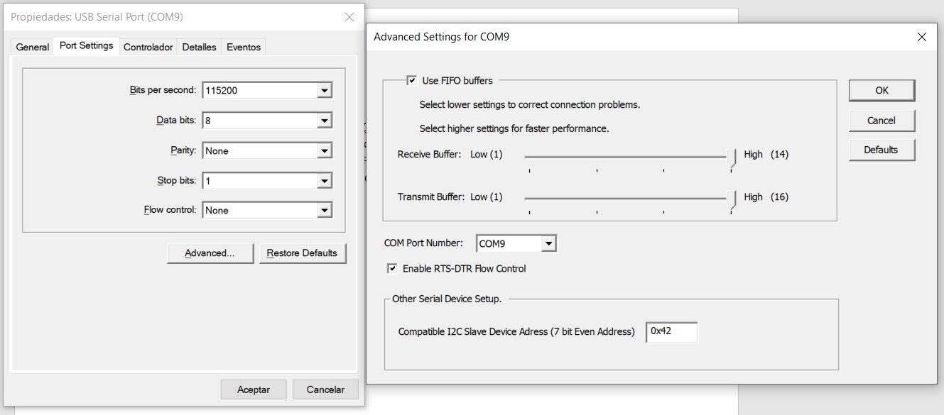

Maybe it's just a small detail that is missing but I don't know how to solve it exactly. I’m trying to communicate my laptop with my ZedBoard but for some reason, it suddenly stops. I follow the procedure indicated in instructions included with the ZedBoard package and are also indicated in this tutorial. I download the USB to UART adapter driver (controller version 3.13.0.59) by Cypress which controls the USB serial port (in this case COM9). The device is identified as Cypress-USB2UART-Ver1.0G. The settings form COM9 are like the figures:
When I turn on the ZedBoard with the SD Card boot configuration, my laptop detects the new device, the green power led turns on (LD13), a few seconds later the DONE blue led turns on (LD12) and the MI07 led turns on (LD9) but later it turns off and at the end the LD11 flicker for a few second. In the TeraTerm terminal appears the instructions and commands which indicates that the booting starts but it stops at line [    1.130000] (see image).

    I repeated the procedure but now without the MatLab connection, and the behavior is the same, the booting stop in line 1.13000. Checking the headers when I try to boot the system in the TeraTerm terminal I found this:
    ** Unable to read "ramdisk8M.image.gz" from mmc 0:1 **
    It is, supposedly, an error from the SD card files but, as you tell before, these files form the OOB SDCARD image, and none reports problems with that. I repeat the procedure with the Matlab terminal without the TeraTerm console in order to avoid port collisions and now the error indicated was a conflict with the USB-to-UART port drivers, in specific, indicates that cannot connect to “zynq hardware”. I’m going to publish this in the Digilent’s forum, maybe someone faced this before and found the solution. Thanks for your recommendations.
