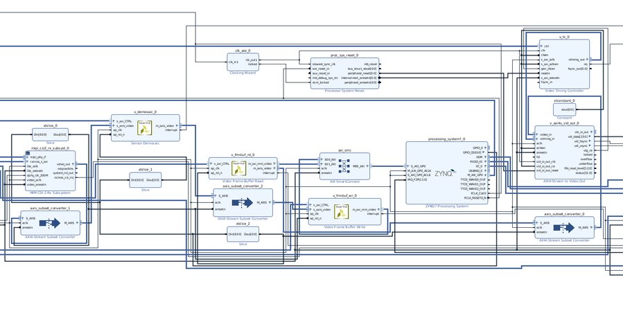

I am building a simple videopipeline using petalinux 2019.1 and trying save images on the SD card , the following is my design
Camera -> MIPI-CSI-RX-Subysystem -> Demosaic -> Videoframe buffer write ->  ZYNQ-PS.

I am attaching my hardware design, pl.dtsi and system-user.dtsi.
Any help is greatly appreciated, Thankyou in advance

    my initial pipeline was Camera -> MIPI-CSI-RX-Subysystem -> Demosaic -> Videoframe buffer write ->  ZYNQ-PS.
    This gave me more propblem broken pipeline, 0 bytes image with v4l2 command.
    I made changes in my setup ->
    First change -> on vivado design
    MIPI-CSI-RX-Subysystem -> VPSS -> Videoframe buffer write ->  ZYNQ-PS.

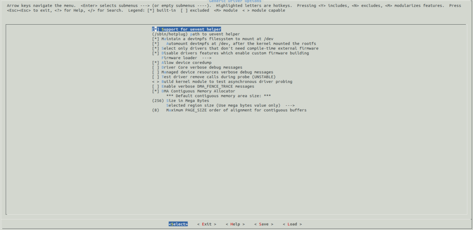

    chosen {
    bootargs = "console=ttyPS0,115200 earlyprintk root=/dev/mmcblk0p2 rw rootwait cma=256M";
    stdout-path = "serial0:115200n8";
    third change - set CMA as 256 on kernel config.
