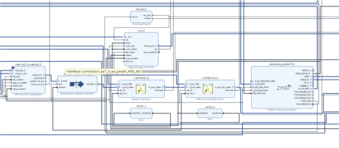

Hello Everybody,
I have created a MIPI image processing pipeline design and built a Petalinux project using zedboard, FMC pcam adapter and Pcam .
The objective is to save the image on the SD card at 720P resolution. The Vivado design can be seen in the Image
I am using v2019.1 of vivado and Petalinux.
I was successfully able to stream video with the similar design using bare-metal application.
During the boot I et the following error
Header 1
xilinx-video amba_pl:video_cap: device registered
xilinx-csi2rxss 43c00000.mipi_csi2_rx_subsystem: Xilinx CSI2 Rx Subsystem device found!
xilinx-video amba_pl:video_cap: Entity type for entity 43c00000.mipi_csi2_rx_subsystem was not initialized!
xilinx-video amba_pl:video_cap: Entity type for entity 43c10000.v_demosaic was not initialized!
xilinx-demosaic 43c10000.v_demosaic: Xilinx Video Demosaic Probe Successful
xilinx-vtc 43c40000.v_tc: device found, version 6.010
The status log mipi csi2 rx subsystem is the as seen below

What am I doing wrong ?
Any help would be great .
I am attaching the device tree files and the boot log and the design pdf.
Thanks in Advance
