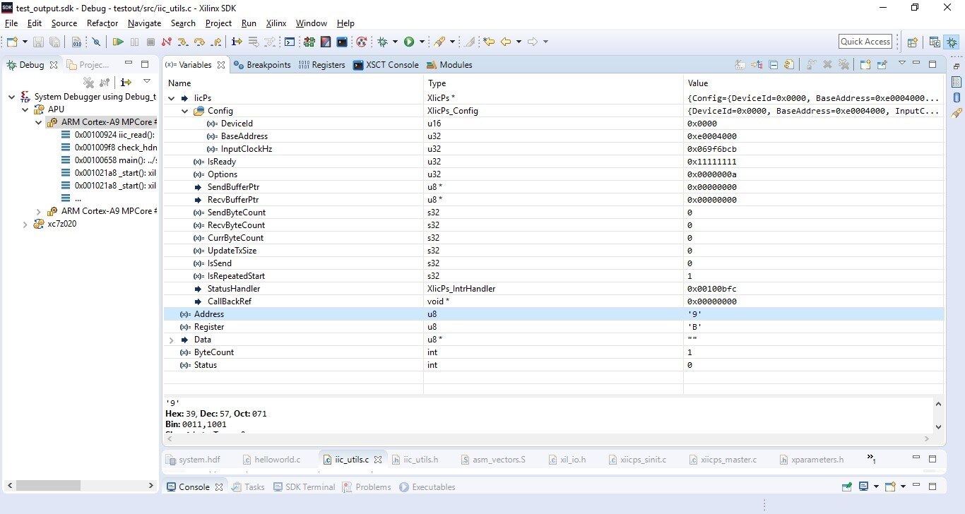

Hi guys,
I'm trying to configure the ADV7511 chip for HDMI output on the zedboard but running into trouble with iic. I have configured device XPAR_XIICPS_0_DEVICE_ID/XPAR_PS7_I2C_0_DEVICE_ID without any issues however when i attempt to do any operation that uses XIicPs_MasterSendPolled the program hangs. I've included an example below where im reading from the HPD State register(0x42) of the ADV7511(iic address - 0x39).
// Set the address of the register to read
Status = XIicPs_MasterSendPolled(IicPs, &Register, 1, Address);
****Variable values at time of call
**Hangs here
* Check for completion of transfer.
while ((IntrStatusReg & XIICPS_IXR_COMP_MASK) != XIICPS_IXR_COMP_MASK){
IntrStatusReg = XIicPs_ReadReg(BaseAddr, XIICPS_ISR_OFFSET);
* If there is an error, tell the caller.
if ((IntrStatusReg & Intrs) != 0U) {
return (s32)XST_FAILURE;
The zedboard has the same zynq soc as the ZC702 board (Zynq-7000 XC7Z020-1CLG484C SoC) so i thought maybe i had to set a iic mux at address 0x74 as shown in the ZC702 user guide however this also hangs.
Hopefully someone can explain why the PS iic isnt working properly
Thanks!

    Hi,
    Are you able to use the PL IIC controller? We have found much more success with that in the past. If not, why so?
    Thanks,
    Josh

    Hi,
    That is what I am attempting at the minute. The PS implementation made more sense to me and was wondering why it wasnt working.
