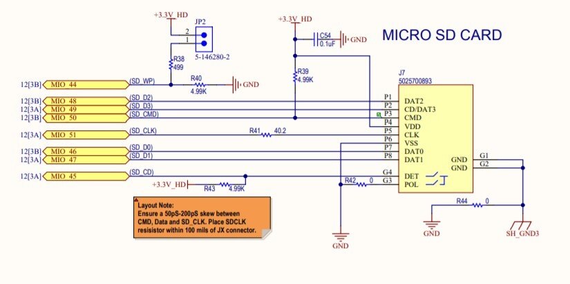

Hello,
I'm trying to use an UltraZed-EV SOM with a custom carrier card. When I try to boot from and SD card on my custom carrier card, I get messages saying MMC 1 busy timeout, and Bad device mmc 1 as shown below:

Has anyone else run into similar problems? Any ideas for solutions?

    Hi there,
    Are you able to validate your software / hardware by using the out of box design, or an Avnet Carrier Card?  You just have to be careful about any IO/etc. that might become damaged at the wrong configuration.
    If possible, that might help you locate the issue (be it hardware layout, configuration for the SDIO controller, other).
    You might also cut the speed of the clock for the eMMC, just to check that aspect (although probably easier to just use the provided OOB files if you can).

    So I rechecked the schematics for Avnet's carrier card, and I realized there were a few pins that I hadn't routed correctly. Here's a picture of Avnet's schematic for their SD card connector.image
    I used the same part (5025700893), but I hadn't routed G4 (DET) or G3 (POL). After doing some hacks on my board and getting those pins connected correctly on my custom carrier card, the boot sequence worked just fine. Any idea why that is?

    First, I'm glad you figured that out!  Boot issues can be really tricky to track down.
    It is likely that those pins are feedback to the drivers.  Typically, I've seen those kinds of things timeout if a toggle or something similar does not happen.  What I recall from a previous experience with something like this - the driver sits there waiting for the pin to establish that the SDCARD is inserted.  Without that, the driver might be "hung" waiting - eventually timing out - assuming that the SDCARD is never inserted.  I do not recall the function of the POL pin.
    I do know that it can be worked around in JUST software, but I would NOT recommend that as you end up polling for activity instead of just being aware of the memory's presence.  I do believe that IS part of the standard (to poll for presence).  However, due to how the driver is provided, you would probably run into longer term maintenance issues with software as I suspect you would then not be following mainline.
    As this is not really a signal integrity based pin, but just logic, I'd suggest modifying boards as you did to start development work for your team.  Then, ensure the proper changes are in place for your second spin of prototypes, or even for your first articles.
