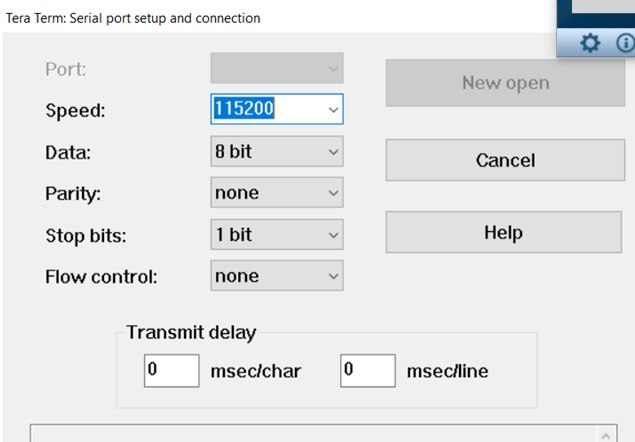

Hi,
My customer just bought a Microzed and gets stuck after installing the Windows10 version of the CP2104 driver:
http://www.microzed.org/sites/default/files/documentations/CP210x_Setup_Guide_1_2.pdf
Any suggestions other than opening a case on Silicon Labs website?
Thanks!
Eileen

    Hi Eileen!
    We have seen this in the past where Windows 10 actually creates TWO Serial ports.  Generally I recommend the customer try both, and remove the non-functional one from the hardware manager in Windows 10.
    Can you see if they are just utilizing the wrong port.  It really is not obvious that the incorrect/non-functional port is being used.

    Hi Dan,
    Thanks for the reply.  In this case the customer sees none!  Here is his screen:
    They don't show up under Device Manager either.

    Eileen,
    I was thinking about this and recalled, I had similar issues a while ago, please check this post to see if that is of any help!
    Ultra96 and Click Mezzanine unhappy with Ubuntu?
    --Dan

    Just an update.  The customer also had a machine with Ubuntu and decided to use that instead.  He has no issues with the new setup.  Thanks for the suggestions!
    Eileen
